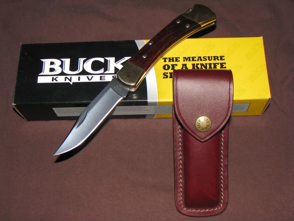

It all started when I decided to sharpen my Alpha Dorado. I decided that since it was 'only' CPM154, I would re-profile the edge to a 20 degree primary and a 25 degree secondary. I thought that this would be done in a jiffy with my Lansky Deluxe stones. After all, I used them to sharpen up my S90V Military with no problem and S30V was easy. So, expecting the CPM154 to be relatively soft, I started with a Medium stone. Quickly determining that the Medium would take a week, I switched to a Coarse stone. That was a bit better, but not enough. Finally, I switched to an Extra-Coarse and proceeded to move some metal. I went through all the grits down to Super-Fine and then stropped the edge. The procedure took me an hour and my hand is still numb!
Whatever Buck does to the CPM154 is nothing short of amazing. I knew there was a reason that I bought two BP110's and two BP Alpha Dorado's. I do believe that I have a new favorite steel.
