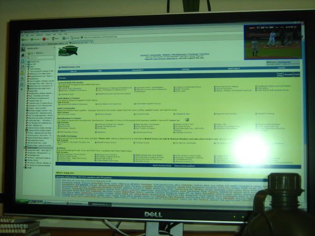

Well, I figured it out with an old VCR. But I'd still like something smaller than that. Still pretty spiffy though... I can watch TV, have side by side computer and TV or picture in picture.
So I'm sitting here looking at BFC and watching the Twins and Brewers in a little window in the corner...

I am too, actually. For a while I was over complicating things and getting confused. But when I realized that there were multiple outputs on the satellite receiver things clicked into place.
After playing with it for a while, I discovered there the monitor has options for the size of the picture in picture window, so I could actually see what was going on in the baseball game, and still have more than enough monitor space left over for browsing BFC.
Baseball and knives, I'm a happy boy (and my girlfriend is happy that she can watch Sponge Bob in bed now).

And yes there is a PC on the floor. One of my old computers had a TV tuner built into the video card, but I never tried it out and my current GeForce 8600GTS doesn't.
I'm pretty pleased with the quality of the signal through the VCR and I hid it under the bed so we're not tripping over or looking at it all the time. And while the 24 inch monitor is too small to be the only television, the bedroom is small enough that the size is perfect.
