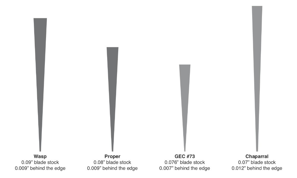

  BTE at 15 DPS:              0.23 mm (0.009”)              0.23 mm (0.009"): from the original 0.64mm (0.025")

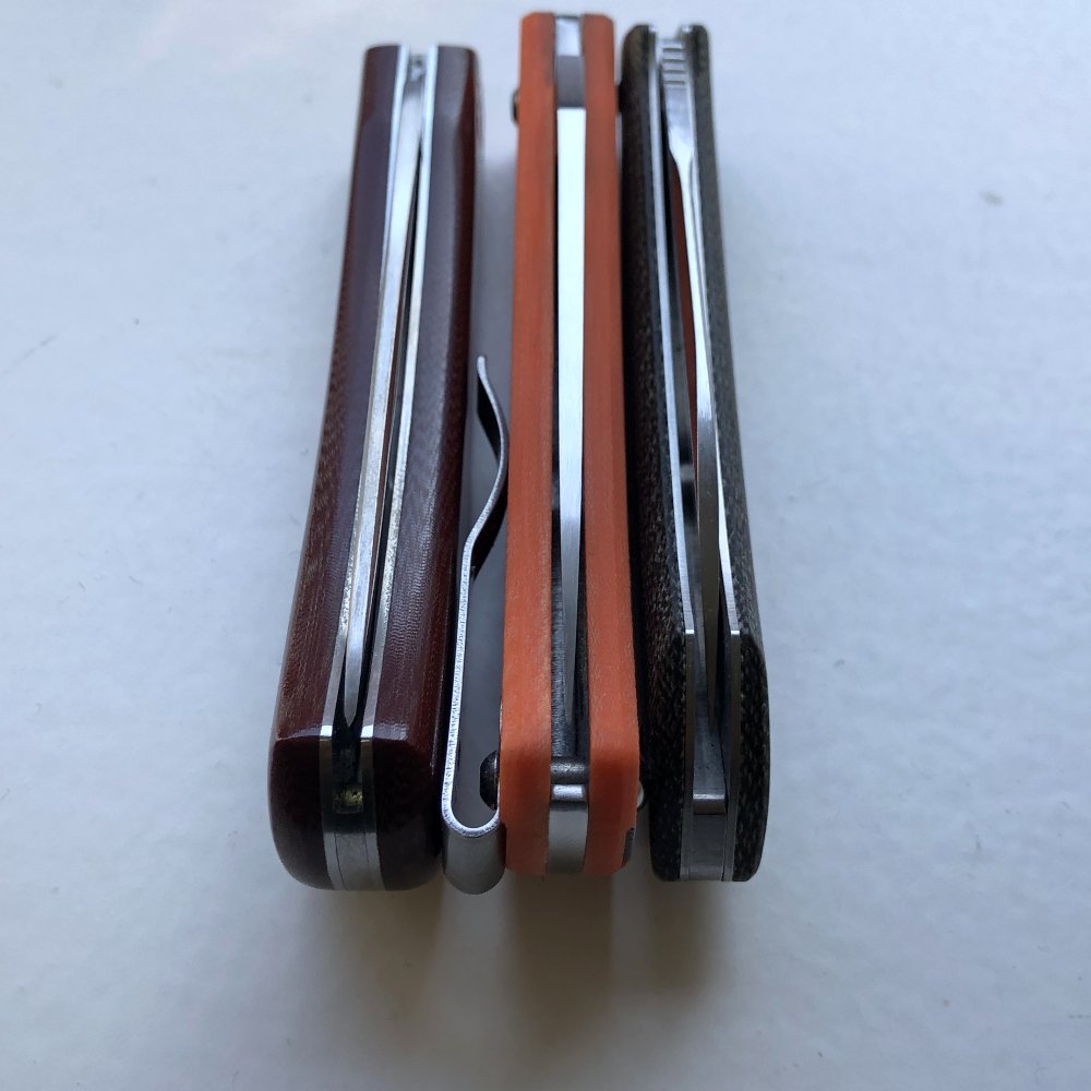

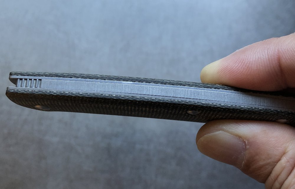

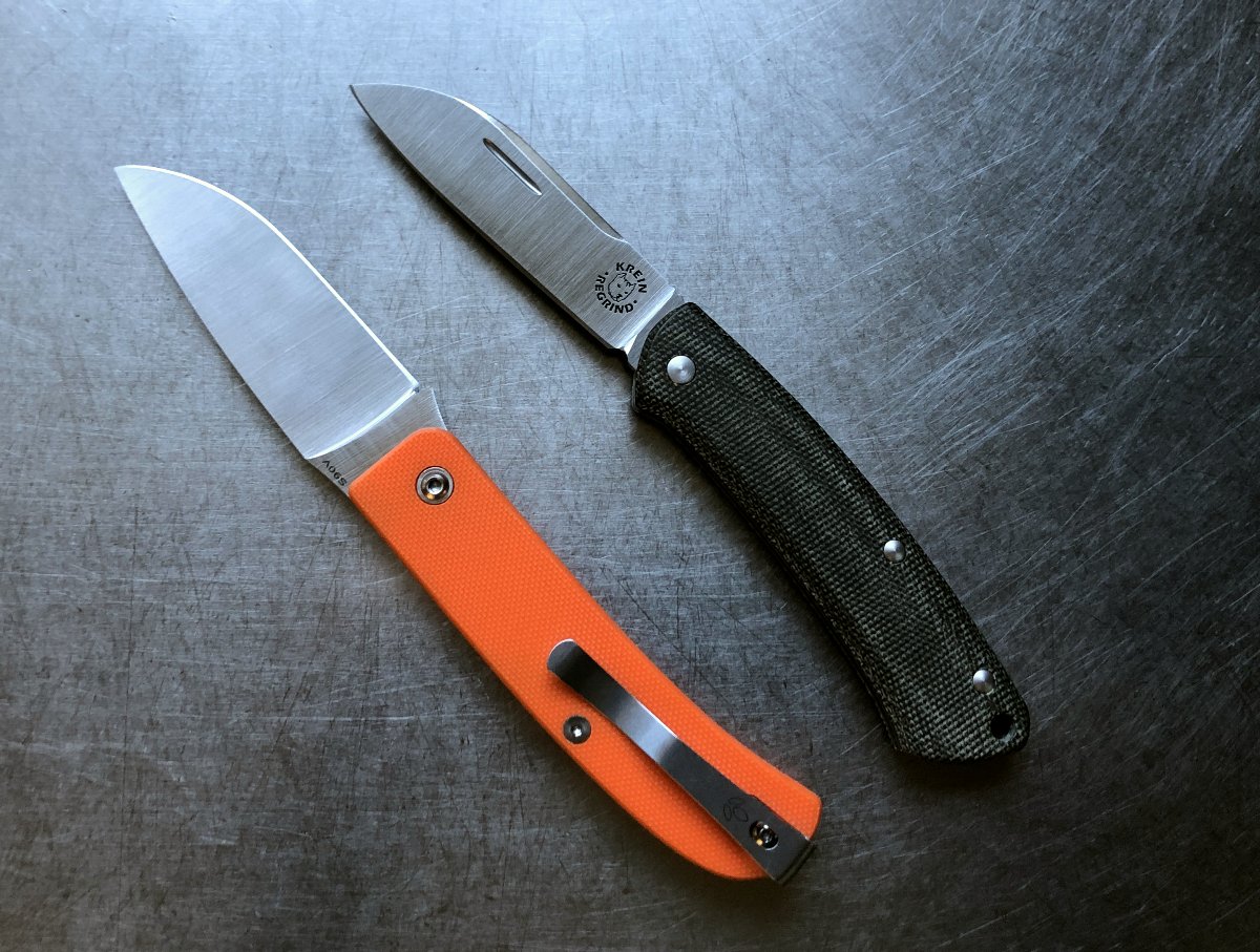

They are pretty comparable size-wise, except for the handle thickness.
Proper is quite thin, as thin as GEC #15.
Wasp is a lot thicker, especially with the pocket clip.
But the handle itself is slightly thinner than Bullnose.
Although the blade heights and stock thicknesses are quite different, their behind the edge thicknesses are virtually identical.
Also, the blade profiles are quite similar, making them comparable in cutting performance.

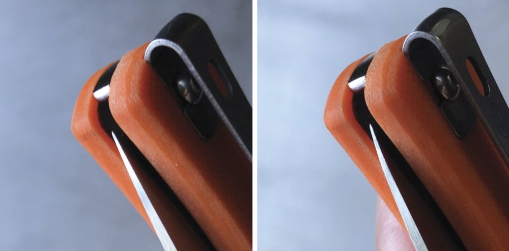

Short travel distance of spring. I don't see the spring protrude much. It is very subtle as compared to GEC and Case. Less chance of breaking?

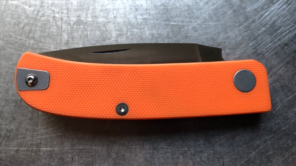

The Wasp.
I got it at about $50.
With S90V?
Just wow.....
But the knife is not cheap.
Nice CNCed blade with a thin edge at 15 DPS (Their factory tour video is fun to watch).

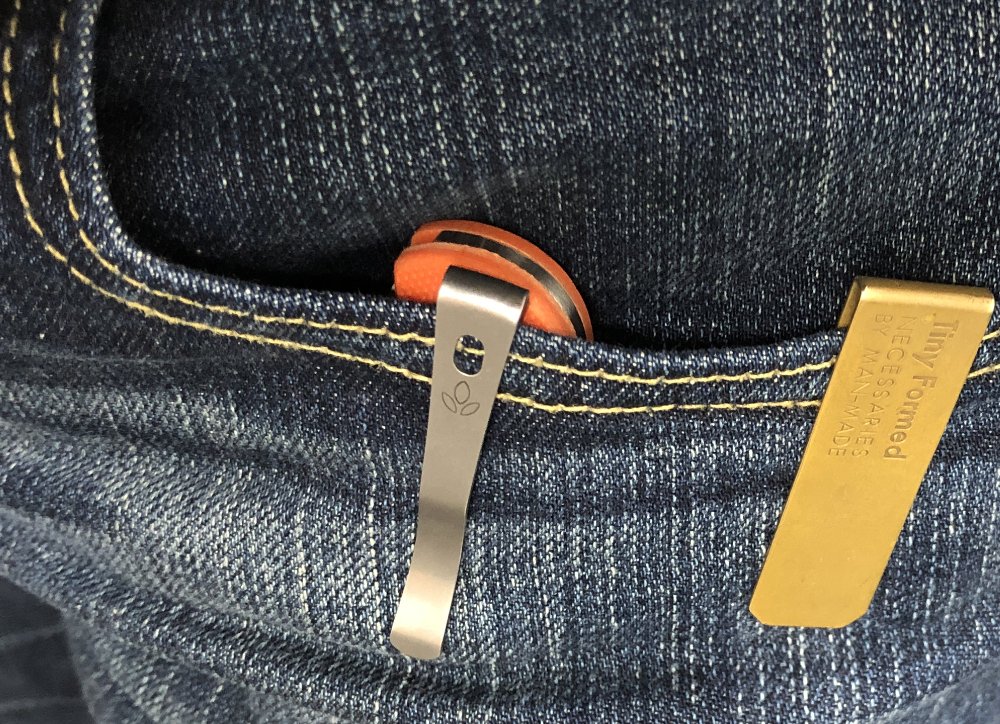

Nice deep carry pocket clip.
The action was a bit stiff at the beginning.
I did my regular flushing cycles, and it became pretty smooth.
I was not sure about the 4 stop pivot but surprisingly got used to it quickly.
The handle feels very sturdy.
The orange G10 scales are pretty and enough grippy.
I do not find the nail nick really useful.
Since the blade is well proud of the handle, you can easily pinch it open even with your left hand.
Some may not like the exposed blade tang.

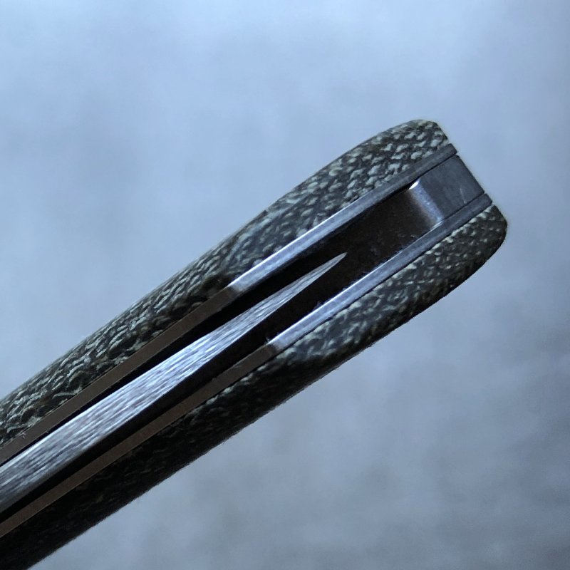

There were few issues with the knife.
The spine of the blade was very sharp.
Because of this, it was painful to close the blade.
I had to sand it with #2,000 paper.
The tip is about to come out from the handles.
I will need to grind it down soon.

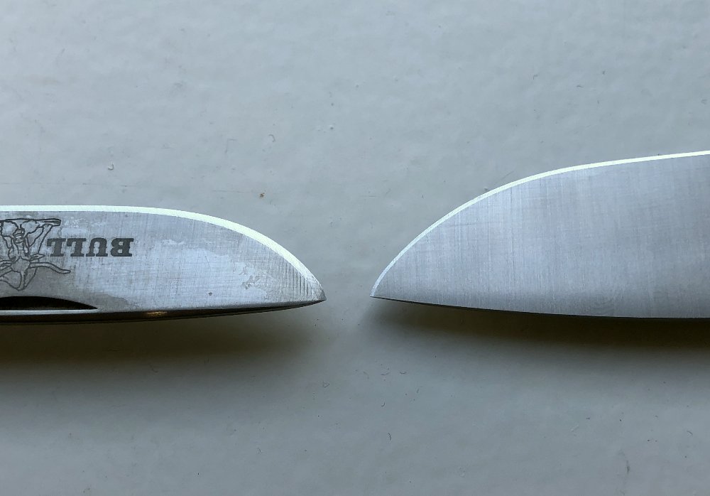

The blade shape is unique.
I take it as a variant of sod buster.
It would be nicer if the point is dropped a bit.

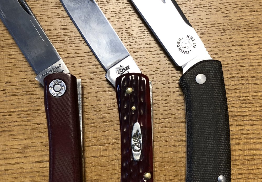

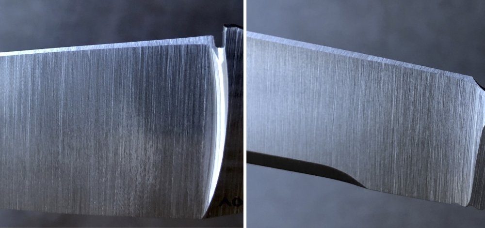

You can see how narrow the edge bevel is for Wasp as compared to Bullnose at same 15 DPS.
Overall, it is a really solid slip joint knife with a nice blade.
The steel feels quite similar to S110V in sharpening and edge retention.
With the low price point and good availability, I do not hesitate to use hell out of it (for a non-locking knife).
This is going to be my travel companion.

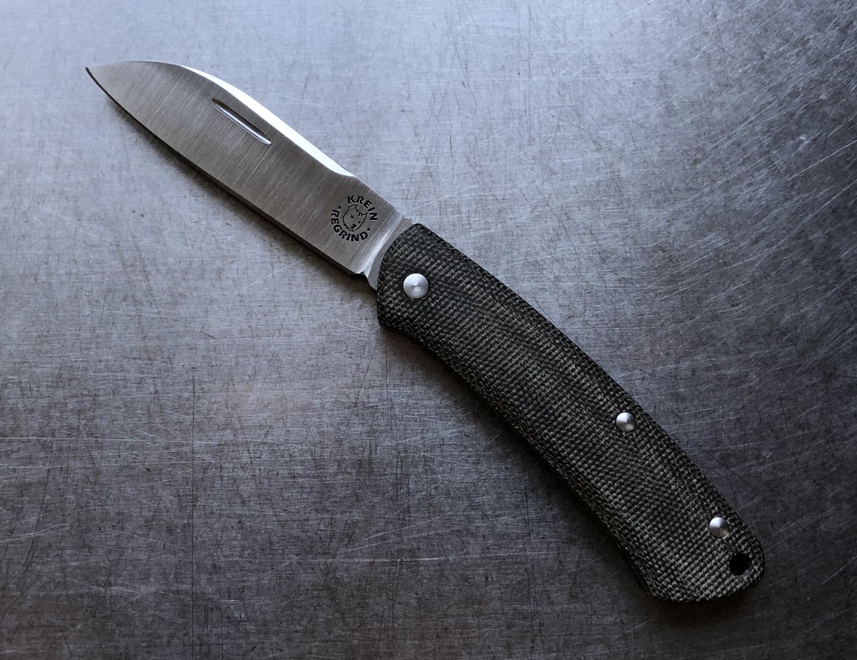

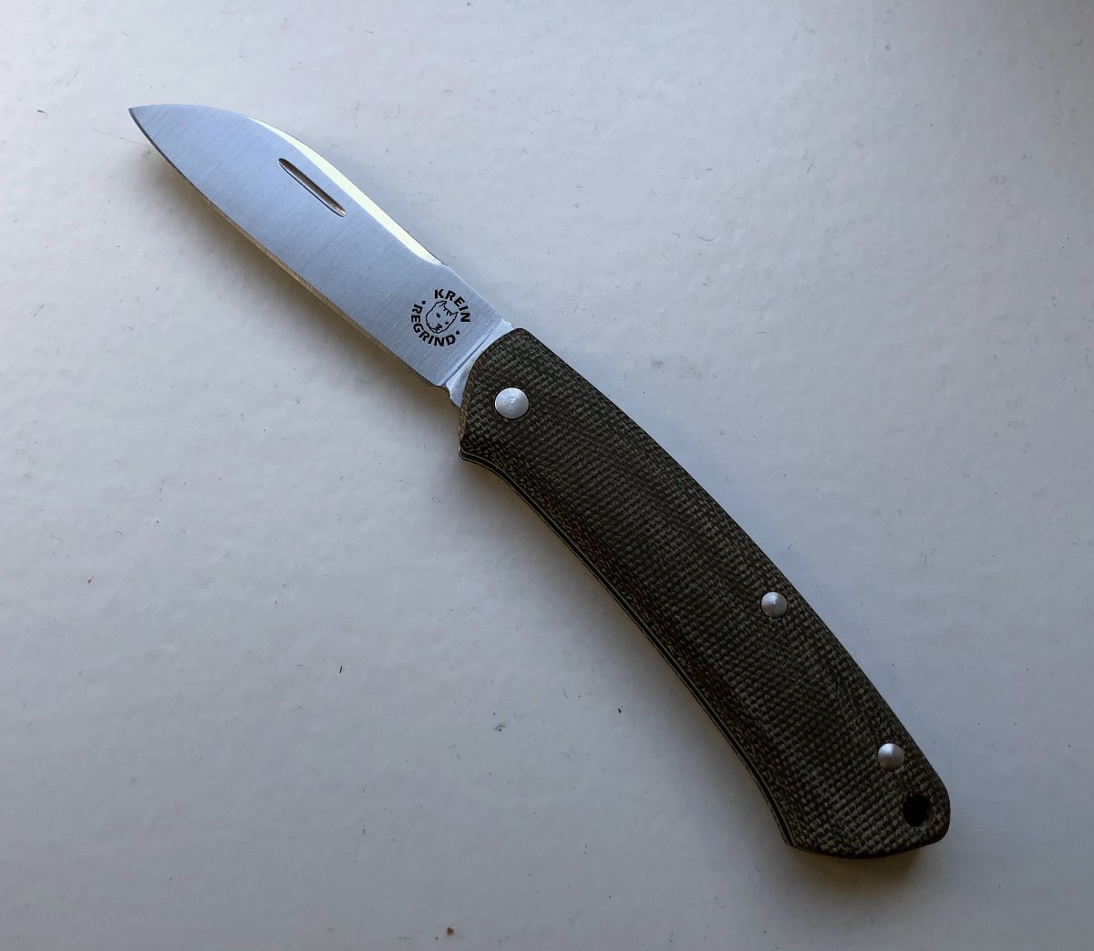

Proper.
What a handsome knife!
First of all, the spring on my sample is good.
It is not strong as Bullnose, but comparable to GEC #15.

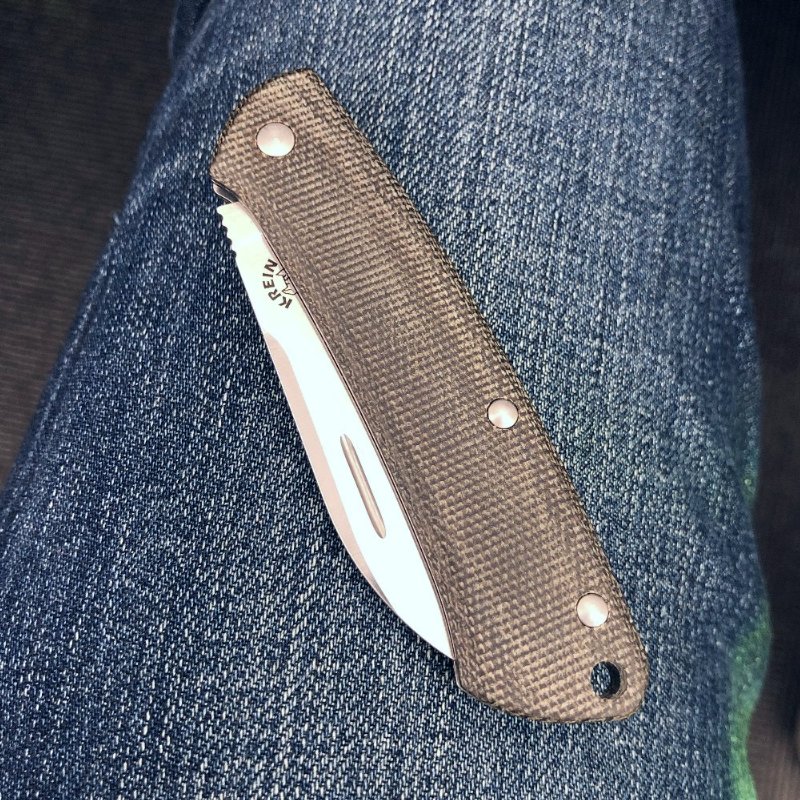

I love the canvas micarta.
It feels fluffy and warm in hand.
It should pair very nicely with jeans.
No pocket clip.
You can just drop this light weight knife into a pocket and forget about it.

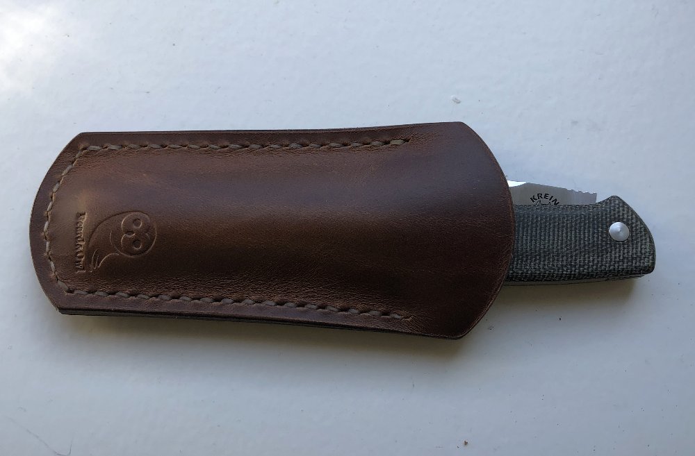

Or you can put it into a pocket slip.
Mine is a medium sized slip (5" x 2"), big enough to swallow this thin knife.
The blade is very utilitarian.
It has a nice pointy tip to penetrate plastic package.
I think the edge line is similar to my favorite Zulu spear pattern.
Very easy to maintain the edge from the heel to the tip consistently on Edge Pro.

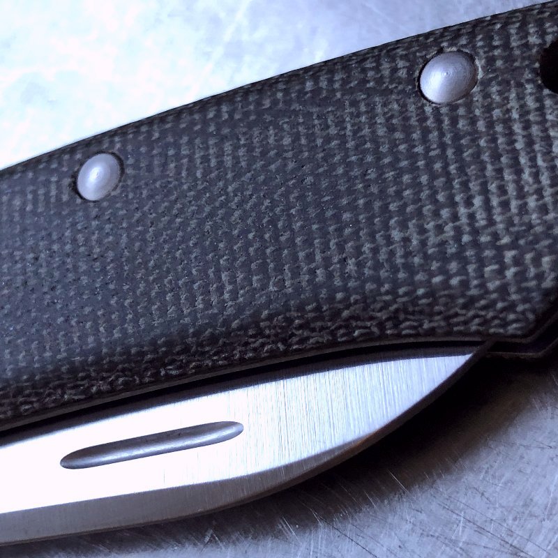

Some issues.
First, the centering was bit off.
I was able to fix it to some extent by tweaking the pivot and scales.
The spring on the back is not perfectly flush.
It does not bother be very much, but some may not like it for a $200 knife.
There are gaps between the liners, which can only be detected under light.
Lastly, the regrind is not consistent and even.
Not too bad.
But it would be a lot nicer if I can get even edge bevels on both sides.
Overall, I really love the knife.
This is my second encounter with S30V.
I thought it should be quite similar to S35VN.
But the steel seems to take a keener edge, and deburring was easier than S35VN.
I don't know if it is the steel or heat-treatment.
Anyway, I love the steel, too.
With the pretty and comfortable micarta handle, slicey blade, good stainless steel, easy deployment, and light weight, I think it would be a great EDC companion.

The clip on my Wasp got loose and could not really be fixed even when the screw is tightened down.
I guess it is how it is.
I will take it off and install a replacement plate at some point.
Regarding proper, the spring of mine is enough stout.
I need as much force as for Bullnose to initiate the motion of the blade to close.
But I can open it much more easily than Bullnose because of the rounded tang and the ramp, and because the spring does not move (or bend) very much.
This is quite different from GEC or Case knives, of which springs protrude a lot during the operation.
I guess this makes the walk&talk feel very different from traditionals.
Actually I consider it a design feature and like it.
Especially, the quieter talk reminds me of Umnumzaan a bit.
Edit:

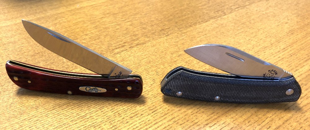

I measured the initial force required to move the blade to close.
I put the blade spine on a scale about 1 inch away from the tip and pushed it down to measure the pressure.
Case Sod Buster Jr.: 0.88 lbs
GEC #15: 1.32 lbs
Proper: 1.54 lbs
Bullnose: 1.59 lbs
You can see that Proper is as secure as Bullnose at the open position.
The blade tang is partially rounded.
Sod Buster Jr. has a fully rounded tang.
But it is still snappier than Proper.
This probably depends on where the spring rests on the blade at each position.
Also, as mentioned above, how much the spring protrudes and moves away from the blade may matter.
The spring of Proper drops a very short distance (invisible in the pic) to hit the blade.
This makes the knife much less snappier than Sod Buster Jr. or Bullnose when opening.
It is as snappier as SAK main blade.
Also, the rounded tang prevents the blade to drop shut from a long distance.
This is how close you can keep the blade away from the handle before the spring forces it to close.
This is probably why the "talk" is not great with Proper, but not the spring tension.
Again, I take it as a design feature and like it.
GEC #15: 1.32 lbs
Proper: 1.54 lbs
Bullnose: 1.59 lbs
