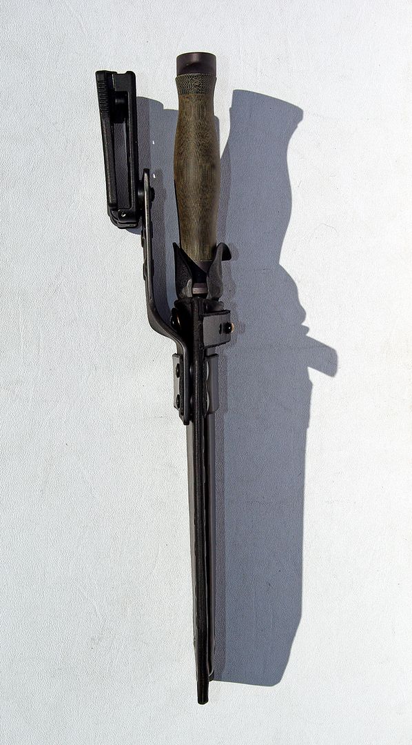

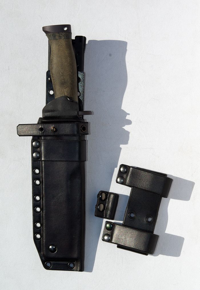

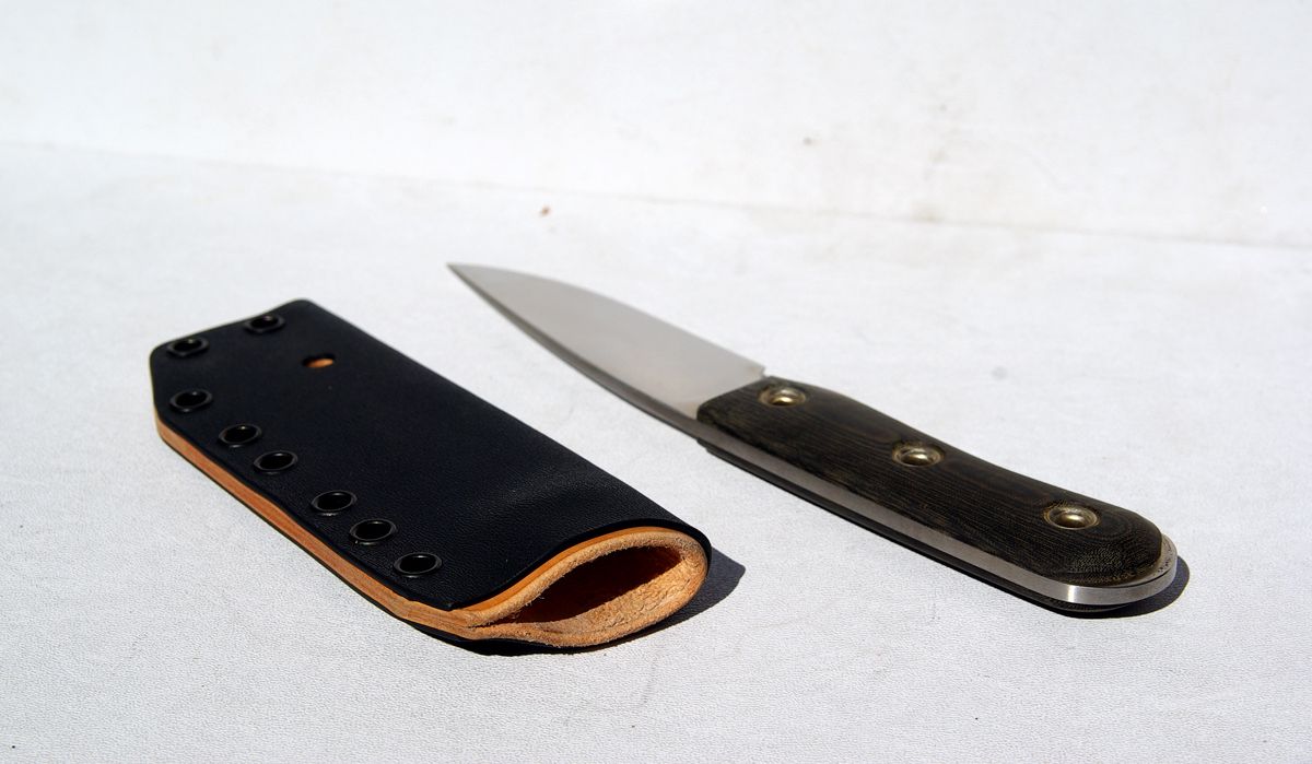

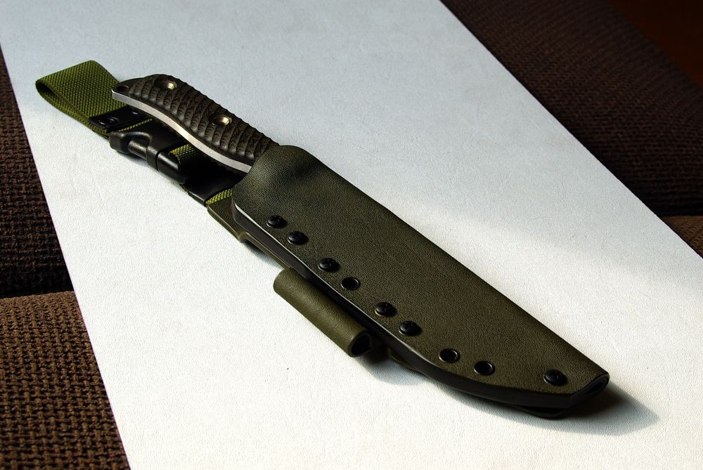

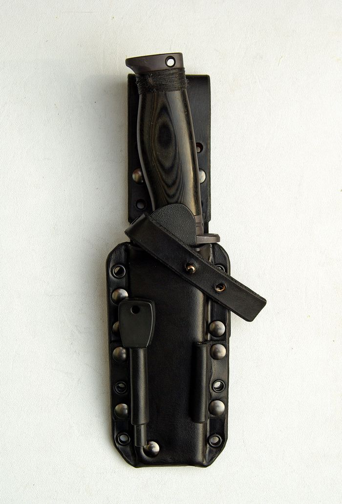

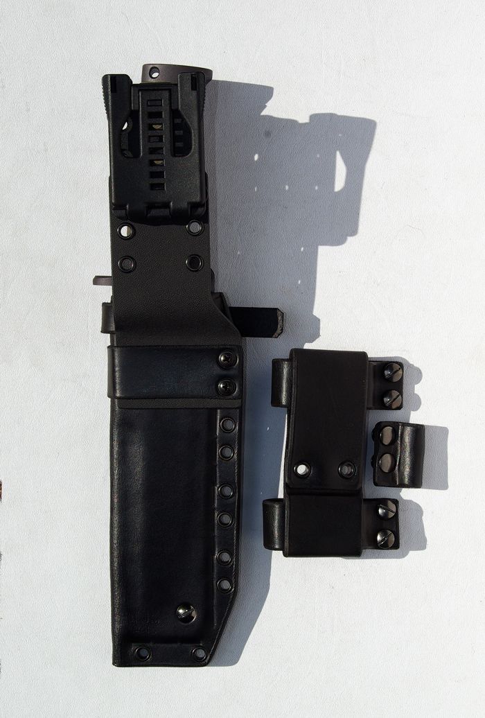

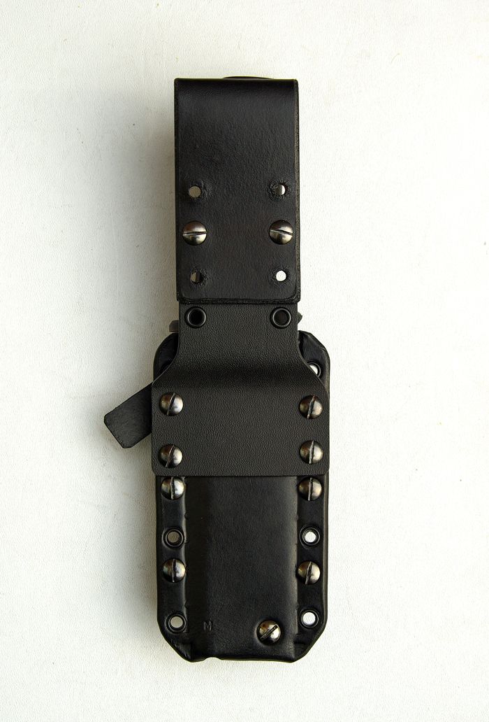

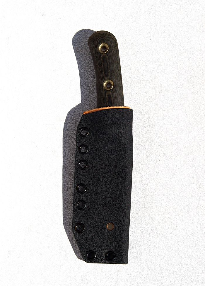

I did some leatherlined kydex..
Swamprat Vex
Spydie Mule Team
Busse Satin Jack
For a user I would reccomend kydexlined leather though.
shoot me an e-mail if you are interested.
I do have a 3-4 month backlog!
