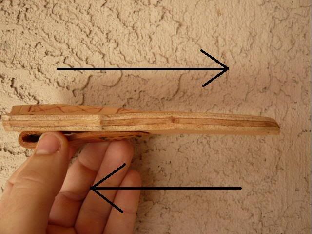

These guys are the experts in the sheathmaking and leatherwork arena. However something seems to me to be lost on me in the technical responses given thus far so I thought I'd give it a shot at a simpler explanation of my opinion.
Stamping , carving, dying, and grain, all may effect the leather but are basically irrelevant to your problem. IMHO, Even given the perfect leather running with the grain, no tooling etc... you'll experience the exact same problem because we can't fold and mold the leather like a machine. Uneven pressures and stresses on the leather cause the twisting.
The solution is a simple one best explained with a pic.
Once your all glued up and discover the twist work the body of the leather like this slipping the body part over the welt part. You may need one side or both just depending on how bad the twist is. Get it nice and straight then clamp it up with spring clamps.
Problem solved.
-The sping clamps will put big dings in the leather so I use some heavy weight scrap pieces under the tips of the clamps.
As a side not I've also experienced the same twisting action while stitching the sheath. Just hand bend it straight as you go and it'ss be fine also.
Hope this helps you out, Josh
