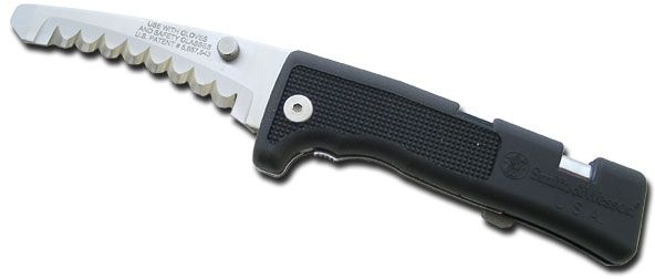

The only production knives I've seen with double or "alternate" serrations on both sides of the blade are the Blackie Collins designed Smith & Wesson First Response folders and the old Meyerco Speedsters. The alternate serrations on the Speedsters didn't cut well at all, but the ones on the S&W First Response are radiused and cut well.
