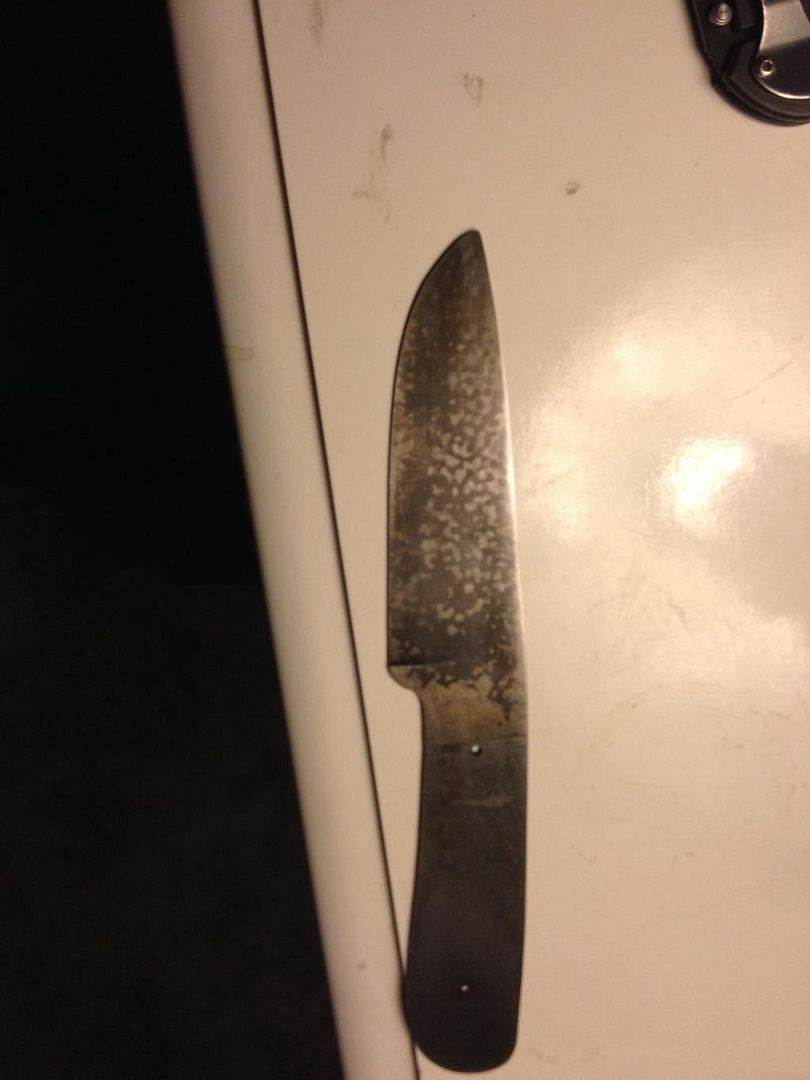

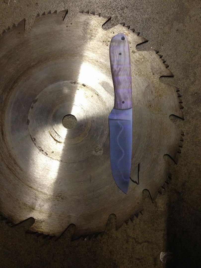

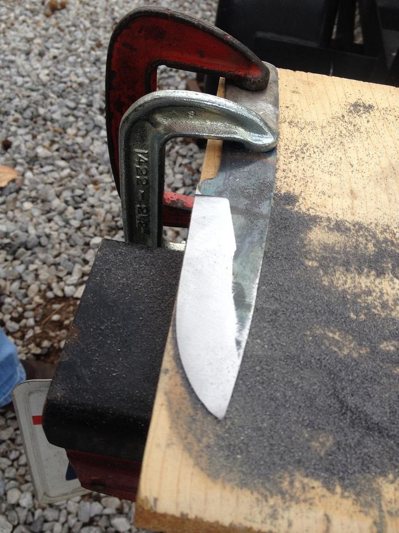

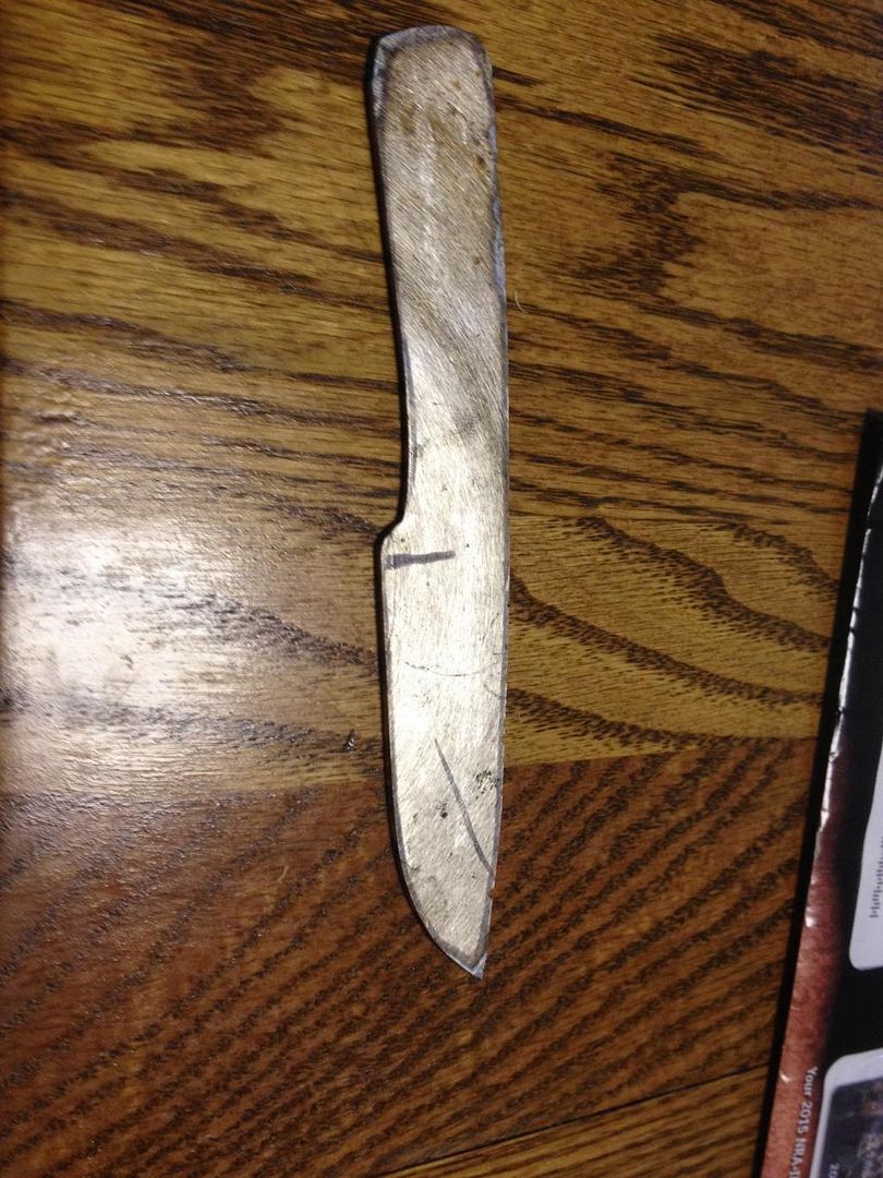

Hey all! This is my fourth real knife, and so far so good, in my mind at least...definately no work of art. I messed around and made a filing jig, and I'm pretty happy with the results! I did a sort of acid etch on the blade using vinegar, low tech, but it works and fits a low budget:). My scales are going to be Koa wood with carbon fiber pins. Right now, as a student whose truck takes all my money to Fix Or Repair Daily to prevent Found On Road Dead, I'm using table saw blades for my steel..please don't hurt me for saying that:). Shane from SA custom knives kindly let me use one of his designs, which I shortened down and modified quite a bit and obviously, mine isn't half as nice. So please give any input or critiques on this one or for future knives would be great!

Hey you did it! Oh yeah and nice job on the hamon looks really good and over all that's a nice little blade.

I was thinking the same thing as Ballew, but that first pic is not your knife its your template yeah?
I personally like bigger pins but that is an aesthetic thing anyways. On pins though, I always over size the hole in the tang to make an epoxy bond as well it makes it easier to get your pins in when attaching scales. I'd also drill a few more holes in the tang to lighten it up and assist with balance and it gives you more epoxy bonding points through the tang.
Aside from that, what i see in the photos is looking good so far.

No, I put that in my first post, that is Shane's from SA custom, I printed out a picture of it and taped it on there, teicky looking though huh! He was kind enough to let me use his design. Ok, I've seen people do that before, I will drill more holes! I've always liked smaller pins personally. Thank you for the input!

Hey, thanks! I appreciate the encouragement, glad you like it! I have my scales almost complete, cocobola and leather...keep an eye out for the finished product on shop talk within the next couple of days if you want to see it! I'm the same way, love making something out of not much...it's a good challenge!!

I like it! Fellow beginner here as a maker, but as a knife enthusiast that looks good. I'm not big fan of etch, but lots are and that's a personal preference. Biggest thing is to start.

Thanks! I'm glad you like it! Yea, this was my first time etching, I think it looks neat but I don't know if I will do it again. Thanks again!
Looks good to me, as a beginner myself, I've been using a Gough style jig to file some knives. I should have some knives completed in the not to distant future for criticism.

Same here! Mine is a very simplified version, but it works great! I will be looking out for yours. Thanks!
