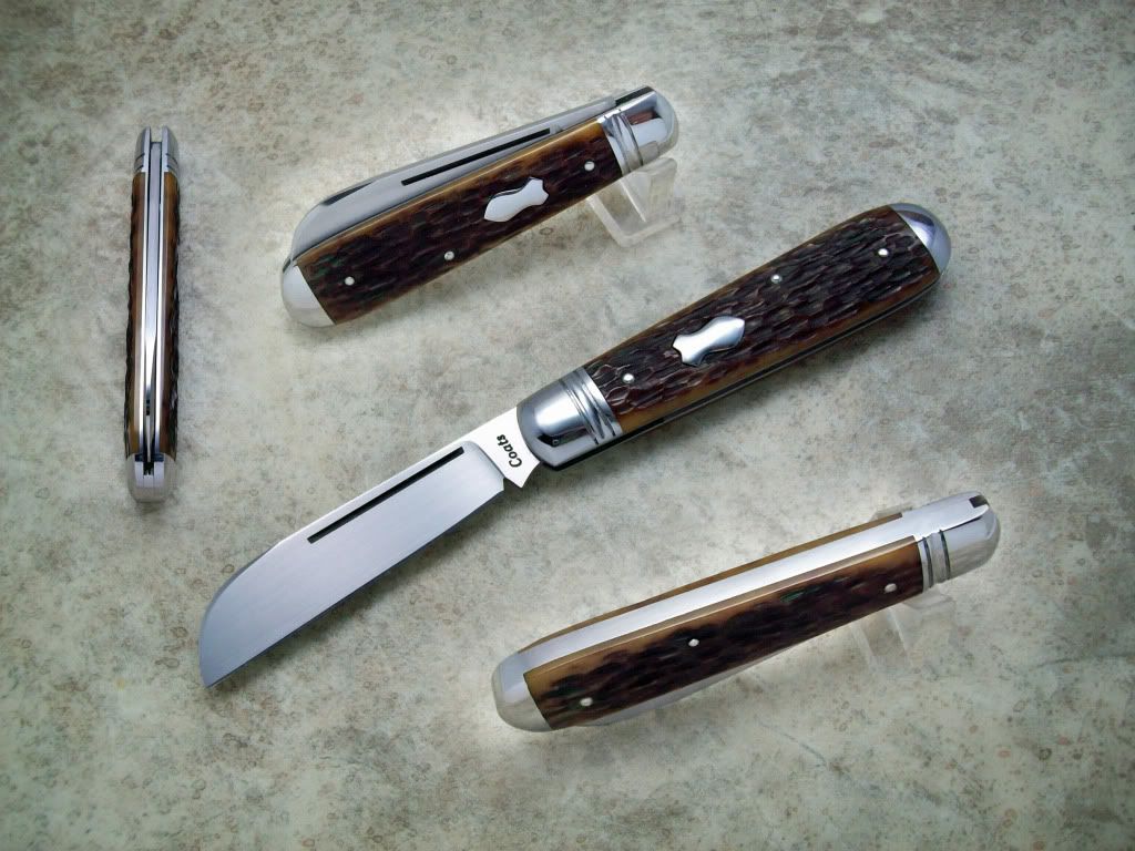

These would make good cigar cutters or tobacco samplers on a frame other than a congress.
Specs
Blade and spring Ats-34, 61-62 Rc on the blade, spring at 48-49, 3/32" stock.
Blade is flat ground, hand finished, drawn swedges
Frame 416 ss, liners and bolsters integral, mill relieved.
Scales my dyed and jigged bone, federal shield is inletted and pinned.
Back is flush open, half stop, and closed positions.
Closed length 3 3/4", open length 6 1/2".
Nail nick cut long pull, the knife plucks easily
all hardware and pins ss.
About a 5+ on the pull with good snap.
Price $425- paypal and priority insured included SOLD
You can say I'll take it here, pm, or email me.
Comments welcome and Thanks for the look, Shipped
in a zipcase.
Ken.
That's a nice looking knife! Love a sheepsfoot and your
bone looks perfect as always.
Jason

The knife arrived today, it is a thing of beauty and the blade shape is also perfect for 'sheeple friendly' EDC :thumbup:. It is a perfect size and weight, feels wonderful in hand, and I love pinch opening blades rather than nail breakers, although the pull on this one is perfect for me anyway. Honestly I could not be more satisfied with it, the only problem is not being able to get in touch with you via email at the moment as having now seen the quality of your work I would love to discuss another knife at some point.
Very fast delivery, thank you!:D
I should add wonderful f&f and the sharpest blade I have ever received.
Andrew
