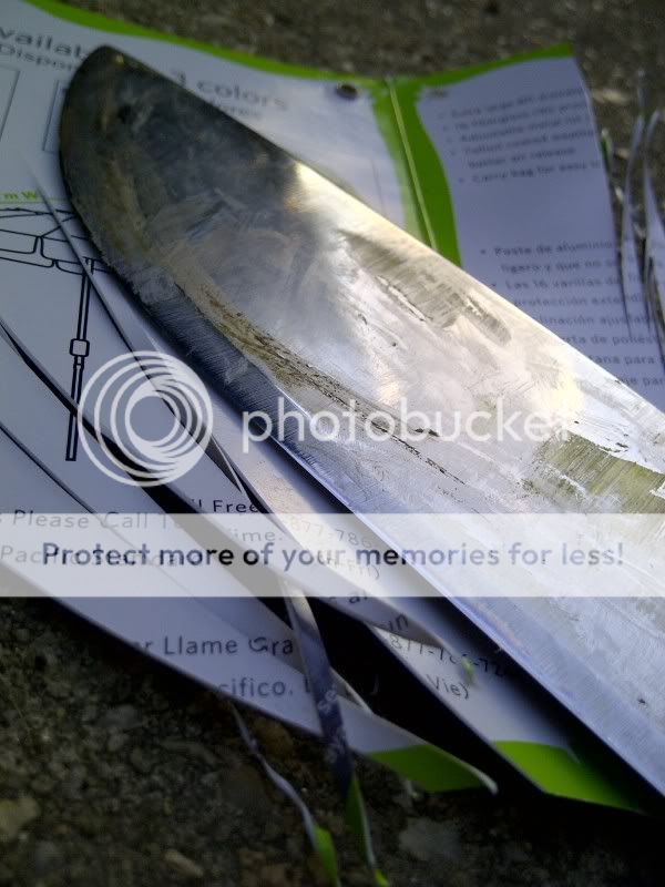

I took my FBMLE thinner and thinner years ago. On my belt grinder. I had a very notted 2x4 I would test the edge on next to my grinder. I don't know numbers but I know I ended up less than 30 degrees with a convex edge. When I figured out what was too thin I ground it back a little. I lost edge doing this, but since these trials a few years back my FBMLE has been used HEAVILY and handed around to be used on lots of hardwood clearing. The edge is good to go.
I would not be afraid to go 30 but then again, I don't know the V vs Convex on this one.
Here are a couple pics of the edge I ended up with:
Some people may shy away and go more for strength, but IMO geometry cuts, not INFI. I want to take advantage of a steel and find the most aggressive geometry I can get out of it. This FBMLE was a dud with the factory edge, after I found its peak it is a chopping demon for a 10" blade.
