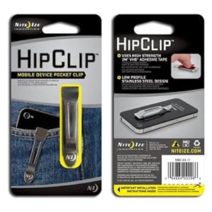

I was wondering if anyone knew how to put a pocket clip on an Opinel without drilling any (more) holes in it. What should i do. As you can see from the pic I've already drilled a lanyard hole in it and switched it from clip point to drop point with a file and some sandpaper. It looks pretty sweet, but i still would like a pocket clip. Any advice would help.
Search for Nite Ize hip clip, or pocket clip. They use a really good adhesive that some folks have used with success.

Talking about the nite ize clip I've used on for a while on one of my multis and its worked well. There is also a thing called a draw clip that is normally used for guns that would work well. Many people have used them on knives and multis.
