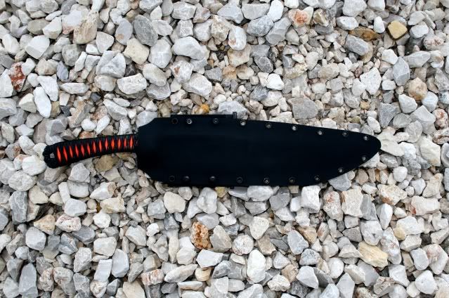

This one and its two brothers that are in the works are inspired by, but not copies of, the big knife wielded by Chris Redfield in Resident Evil 5. The knife is forged from 1 1/2" x 1/4" 1084 plain high carbon steel, triple normalized, single quenched in canola oil, and triple tempered. The overall length is 18 3/4", with a blade length of 12 3/8". The clip is fully sharpened and will shave hair. The handle wrap is neon orange paracord for the underlay, black paracord for the overlay, and black for the triple strand Turk's head knot, all impregnated with Minwax Wood Hardener. The sheath is Kydex with two MOLLE locks.

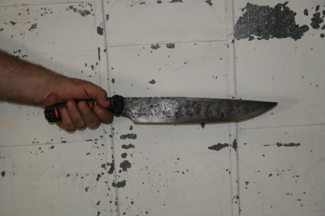

I took a picture of it in hand, but I think even this doesn't really convey just how big this thing looks in real life. I don't name most of my blades, but this one demanded it be called Aggression. And I didn't feel like I should argue with it. :D

Incaorchid - Sure is for sale. It'll be on my table at Blade here in a couple of weeks. (Table 4CC! :) ) The wrap is based off of one I saw on a Mongolian saber handle at a museum exhibit on Genghis Khan a while back.
beautiful. I am a fan of all the RE series except 5 but there is no denying that is one heck of a knife. I would gladly slay many zombies with that one.
Quick question though...How is the balance? Looks like it would be a little front heavy from the pics(in my opinion).
Evilbrojoe - Yep, it's blade-heavy. Kind of hard not to be with a blade that large. :D I don't remember where exactly the point of balance is on it, but I'll try to check on it and let you know.
