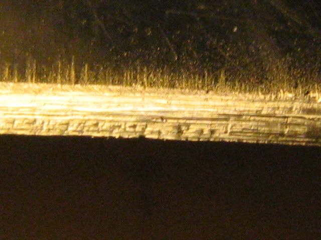

Ive found that the Benchmade sharpeners aren't too too bad, I only use it for very bad edges and I find that I can do better work with tips on my sharpmaker after I use the pull through, I don't have a nice enough camera to capture the edge it puts but yes it does take off a lot of metal.
