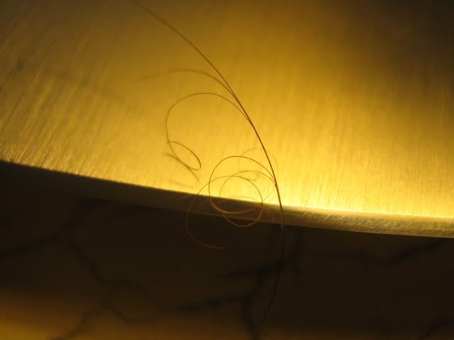

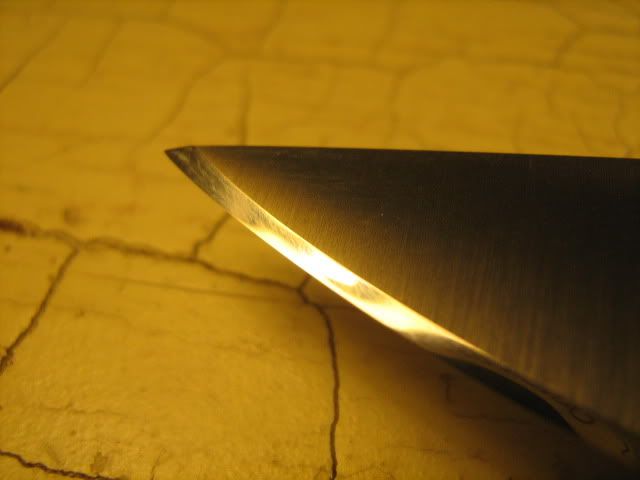

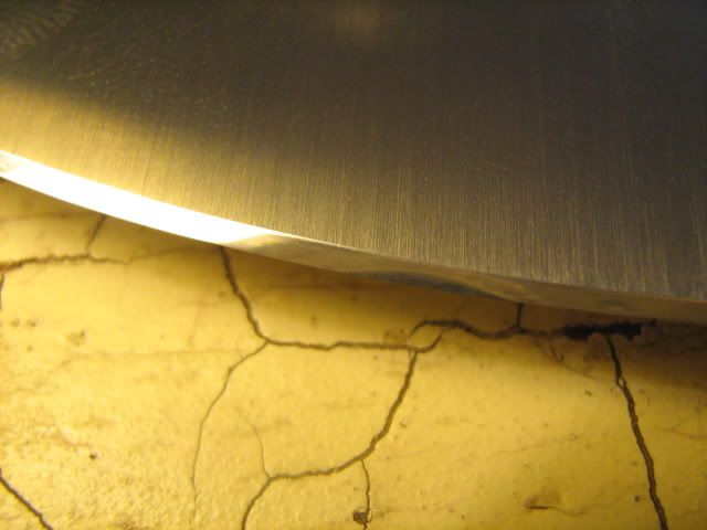

The DMT EEF has been a stone that does not seem to get the credit it deserves, I know their are some of you that have decided to invest in this stone but from experience know that first impressions can be depressing. I have been using mine for about a year now and while it sill has some breaking-in to do its broke-in enough to show the rest of you what a little time and patients will bring you.
Diamonds can polish you just need to give them time ;)
Spyderco military S30V.
A shot with outdoor lighting up close
It's sharp too :)
