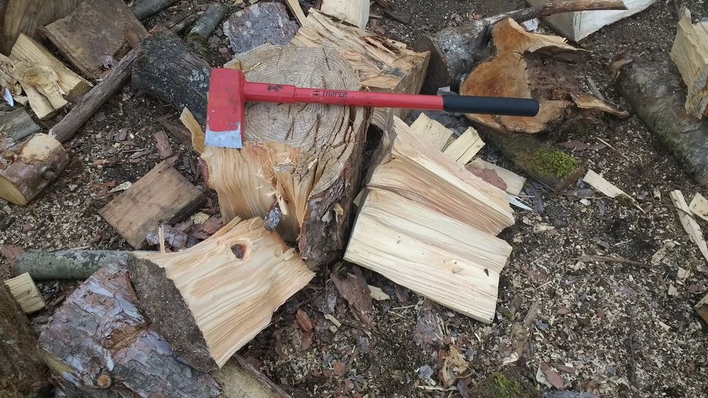

How sharp should a maul be?
Keep thinning it until it doesn't bounce
Axes are designed to slice and mauls (and splitters) are meant to cleave. My splitters are merely kept pointy and acute angled enough so that they don't bounce out of the wood. Making them super sharp only increases the chances of sticking if the wood doesn't separate.
Yup, that's why I thin them until they don't bounce,no further
out the box alot of mauls are too thick and lose energy on strikes from lack of penetration.
Thats what works for me
Yup, that's why I thin them until they don't bounce, no further.
That's what works for me

I bought a 12 lbs monster maul and instantly regreted it. The geometry was so obtuse I had zero penatration and all that energy was absorbed by the round and would just bounce.
So I thinned the cheeks closer to a zero but convexed the stock bevel into the cheeks
Much better. But now it takes more expert use to keep the edge out of the dirt.
Can't just swing it recklessly into the ground.
Unless I want a thinker more tiresome edge that bounces.

Not all woods behave the same (good luck bouncing off knot-free Pacific Alder or White Ash no matter what shape the axe or maul) but once you've experienced the frustration of 'bounce' you do not forget. You could mirror-shine hone and sharpen the tip of a maul and it'll probably 'stick' but that doesn't do much good either.
My experience has been that the grind behind the edge makes a huge difference.
So I grind it down, stop and test on wood until I get the desired effect, less bounces more splits

My experience also. Had a few splitting wedges that didn't like to start well at all, so I ground a nicely blended convex about 2.5" deep that reduced the apex angle and removed the harsh shoulder and now they start nice and easy and blast the wood apart with an amount of force that just would have had them bouncing and falling over before.

I learned from Square Peg to make a concave sharp edge ...
Concave it enough to make it bite (not bounce) but without sticking (should easily remove from the wood). I just kept thinning and trying it on different wood till I got what I wanted.
