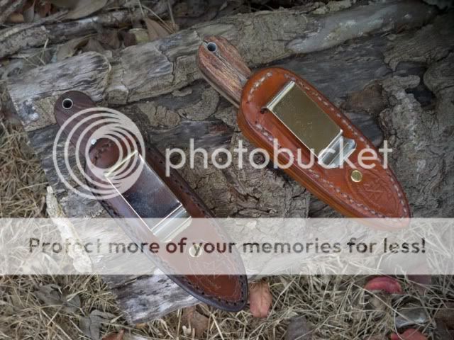

Since the first photo in the OP's post is mine and of a sheath I made, I'll comment :D
The clip assembly is riveted only to the patch of leather.
No metal comes near the blade.
The other reason for the patch was a recess that I cut into the leather to allow the clip to securely lock in. There is a rectangular hole right where the bend in the clip contacts the leather of the patch.
In the past I've had these clips ride or slide off of a thin belt or waistband of my pants.
I got the patch with slot idea from my Gerber Mark 1 sheath.
I'm flattered that you saved the shot of my sheath and used it here.
If my explanation wasn't clear enough I can shoot a better photo.
Good luck and post up your finished piece.

Yes, the type of clip shown on my sheaths there are new from Tandy, they offer a wider bend to accommodate a thicker material to clip to. SWAT boots have a heavily padded upper therefore you need a clip that will easily go over that. Just don't tell the fellow that the extra room was originally intended for purses. These also don't have that "hump" in the lower part that is so difficult to work around. I can get the item number off one if your curious, they also come in black. I use both the "hump" version and this shorter version quite a bit. The ladies, and well most everyone else, loves the short clip for its wide bend, it clips to so many more things than the narrow bend ones do.
Are they still a pretty tight fit without the hump? An item number would be great. I thought about getting on their site, but apparently the blizzard has knocked out their webserver lol. ( I dunno if that's correct, but it sounded good)
Yea, they are very stout little clips, fully as wide and strong as its stablemate. At the thickness of leather I use, 7/8 oz, the hump all but vanishes and becomes useless but for a pain in the neck to cut the slot in the right place. :p
part number is 1240-00 for the nickle plate
1240-24 for the black
