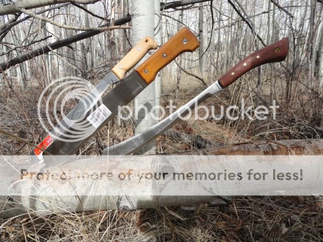

I started out with a Ontario 12.” This really is still my go to blade, what I measure all others too. The 1095 steel holds a great edge. I tried out a 12” tramotina and found it to be very light and quick handling. The edge retention on tramotinas seems to be the pitfall. The need a lot more attention (or so it seems) then others I have handled

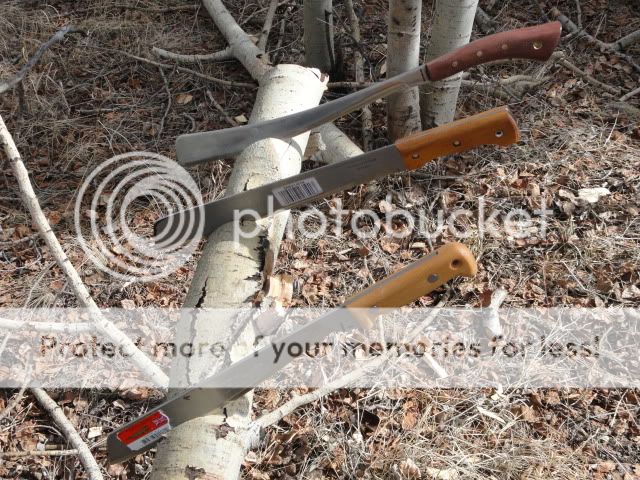

So fast-forward to today and I am still testing and looking for something better. So this spring I did a couple of quick tests with some new models I have been working on
1. Condor Parang. This has been modified by shortening it about 4” and removing the pesky black coating. I added a more refined convex grind.
2. Tramotina Golok. This started its life as a full size 18” Bush Machete. It was chopped down by about 4.” It was re-profiled to a Golok shape with a convex grind. (Great Idea Pict)
3. Martindale Golok. Stock form, I cleaned up the handle and gave it a good multi phase convex grind
First thing I noticed was weight, more specifically where the weight was and how that affected the handling. The Parang while being the thickest was the quickest in the hand. The Tramotina was very similar only lighter, yet the Martindale seemed confused. It was clearly a weighted type machete but had a weird balance point.
On to chopping, most of the wood I encounter is of the dry or green Aspen or Pine variety. I get into some willow and thicket but its too early in the season for that. We still have snow in many places.

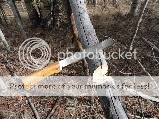

So having chopped a bit with them the differences became very apparent.
The Parang swings easy and hits hard. It feels like everything I put in gets to the wood. The handle shape also lends to a comfortable swing. I tried this thing out last year in its stock form. It felt overly tip heavy. Trimming it up has really helped the balance. I wish it were a little thinner, I think it would chop better.
The Tramotina Golok was tearing it up. It was wicked fast to swing and due to the thin edge and speed it really cuts. Like all Tramotina’s the handle works well and is comfortable. The balance seems near perfect.
Now, the Martindale. It certainly feels better in the hand sitting in the shop then it does in the field. It has a weird feeling of bouncing off what is being cut. I attribute this to the blade thickness and shape. It felt like a lot of energy was wasted chopping. When cutting at an angle it has a tendency to deflect off at a angle. Not only is it irritating but also dangerous. The handle was comfortable but was on the thin side. I also didn’t like how the rivets protrude from the handle.
So this little outing has reinforced one thing. Thin blades seem to work better in my environment. While I didn’t have a chance to work any green wood, the thinner blade seems to just cut better. While the extra weight of the Parang seems to develop more energy but the thicker blades keeps it from cutting as deep.
The Parang can make impressive cuts as illustrated above with a single swipe.
I tend to favor the Parang so far. Maybe its because its so different from everything else I have. In terms of chopping performance it is probably even with the Tramotina. The Tramotina has the advantage of being thinner and probably edges ahead slightly. The Martindale has left me so far disappointed. I will continue to test it, I just had higher hopes.

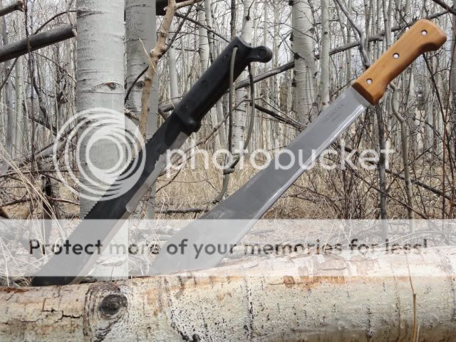

Two more Machetes’ enter the Malay
14” Tramotina Bolo and a Saw back Ontario 12”

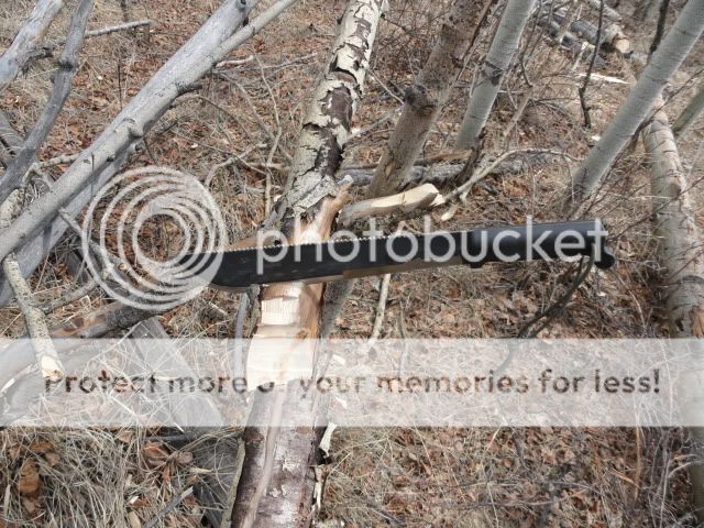

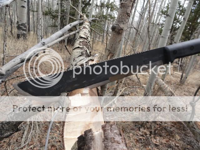

First off with the Ontario, my current favorite in its plain back version. I picked the saw back a while back before I had a clue how to use a machete. It has a flat thinner grind with a more robust convex chopping edge.
Chopping…………..
For not being as sharp as the others in testing it did rather well. I didn’t have any weird harmonics smacking it around. The handles on the Ontario’s are built for speed not fun. While it didn’t leave any blisters it could stand the same finishing treatment my other user has. Remove the gaps, round things out a bit more, just generally clean it up. This is a .125” 1095 blade that is really well rounded for general use.
Saw work or more accurately lack there of………
So the saw feature is useless. I kind of expected that going in and can be fairly said about most saw backs. The saw doesn’t cut the shape binds up the blade, making an already dicey situation even more. This Machete will be dedicated to use somewhere so its really not that big of a deal, but anyone asking, a saw back feature is worthless. To be more accurate while I didn’t try it, battoning with one could even be fun to watch!

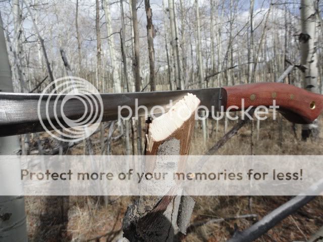

This machete seems to exemplify value vs. performance! She can be had @ $6.75 without a sheath. .050” thick with 1070 high carbon steel.
The handle is comfortable, its light in the hand, fast, and the weight just feels like its right.
She chops like a champ and its fair to say it’s the best chopping machete I have used yet.

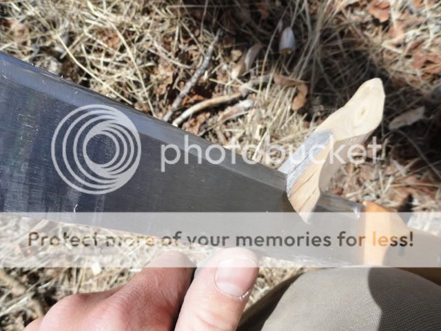

Its was given a nice convex edge, robust in the chopping zone and little thinner near the handle to allow for finer work. The backside was rounded out the tip, yet sharpened square just ahead of the grip for fire steel and scraping.

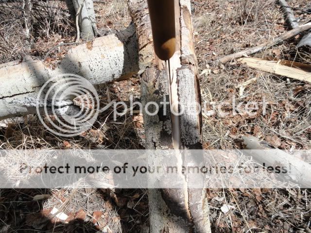

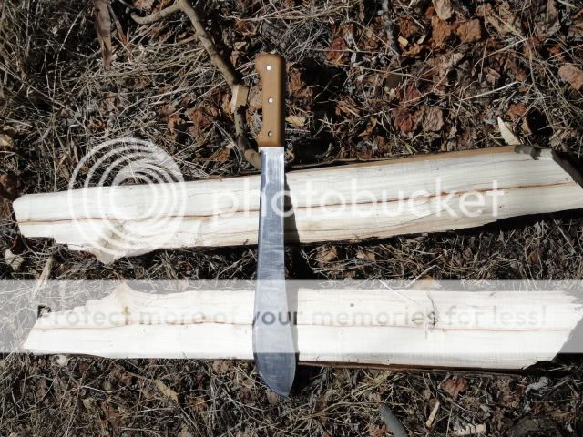

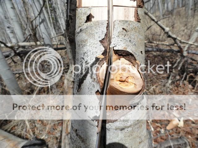

All right so far so good I decided to start pushing things how about battoning ? I took the Tramotina to task
Punched her right into a knot. You can see the flexible nature at work. At this point I was convinced I was going to see some lasting effects from this, I.E. edge damage, bending, etc.

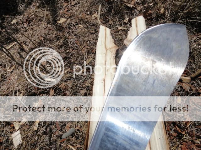

Here is the finished product split clean down the center directly through the knot. I was pretty surprised to find no damage. In fact the edge was paper cutting sharp just like before the split.
Nice and straight

Here’s a shot of the test group.
I have all but given up on the Martindale. As outlined above it just sucks for my use! The rest of them work well with the Parang, and Tamotina’s leading the pack. I really like the portability of the Ontario which usually stays nestled in a pack.
