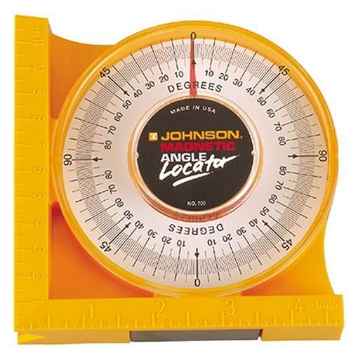

At Lowes they sell a device for $10 that you can put on your stone that is propped up and it tells you what angle your stone is sitting at relative to the countertop. I set my stones in a rubber stoneholder and set the end of it on top of other stones or objects until I reach the desired angle from the counter. I hold the knife parallel to the counter letting the propped up stone hold my angle for me, picture a 1 sided sharpmaker tilted 90 degrees. It works well enough for me at keeping my angles where I want them. It is kind of like training wheels freehanding that I probably don't need at this point, but that is what I have been doing for years and I am a creature of habit.

http://www.amazon.com/Johnson-Level-Tool-700-Magnetic/dp/B00004T807
