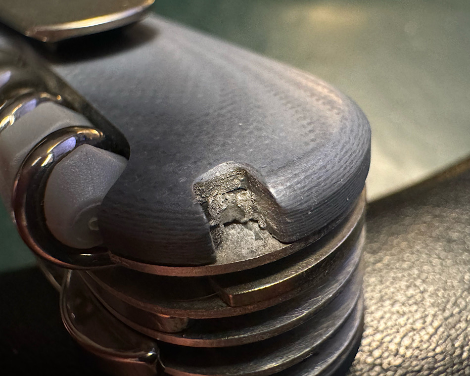

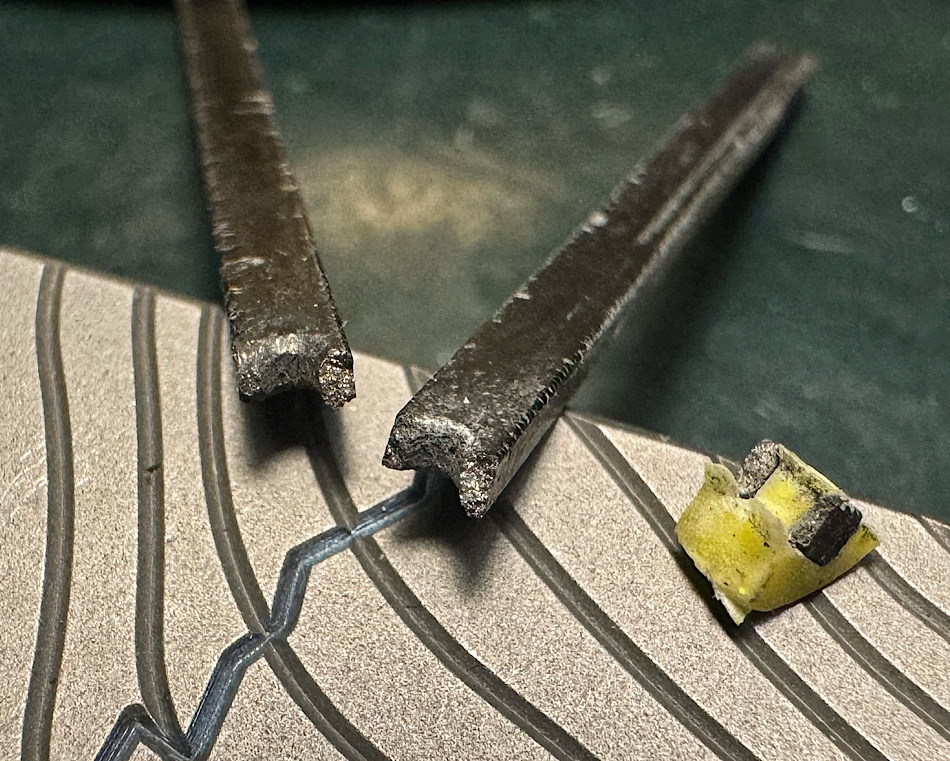

I advise caution if you consider replacing a toothpick with a FireFly ferrocerium rod on your SAK. I've had them in two SAKs for a couple of years and used them occasionally (and REALLY liked them). But over the last summer, they just sat there quietly. Since I used these a few times (after all, that's what they're for), they started to oxidize on the surface. Unfortunately, this also happened in the hole where the firesteel was drilled, and the pull tab was installed. The oxidizing residue "sealed" the whole thing in the slot, and the oxidizing/corroding area around the hole weakened it in that spot. Today, I needed to pull one out... snap! It broke at the hole. After diagnosing the issue, I immediately wanted to save the second one, but the tab also broke at the first very gentle pull! One would be bad luck, two is not. Of course, there was no chance of quickly removing it, so I had to take off the scales with tools (and care). Both were custom-made (G10 and Titanium), so... scraping epoxy, cleaning, re-gluing, and the whole nine yards. Three hours in total to do it well. Still, I'm happy this didn't happen somewhere in the wild, especially not in an emergency (for which it was designed as a starting point).
Anyway, I'm done with firestarters inserted into a toothpick slot. I knew there were some to be screwed into a corkscrew, but I preferred a ferrocerium and a micro screwdriver over a ferrocerium and a toothpick (which I can always carve from a matchstick or twig in 5 seconds). I mean, I used to prefer it.
Or just remove them once in a month, clean, lube with WD40, insert back. Should work. But in emergency gear I don't like 'taking a chance'.
Some photos... yeah:
