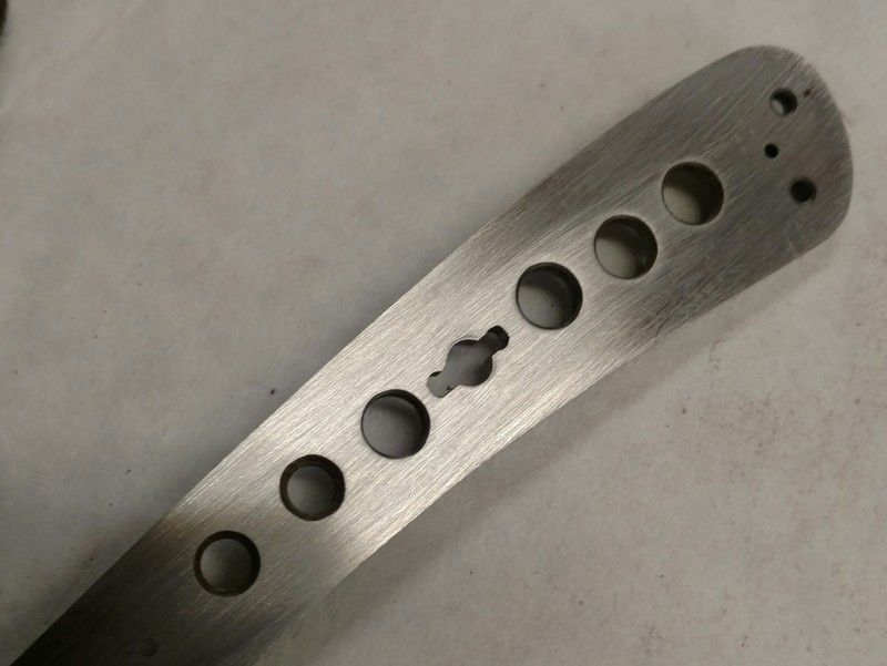

We'll see how this works out, the key, pin, shield (?) weighs less than a 1/4" pin of equal length. It will have one 3/32" pin in the rear, and one up front. If you can picture that in Blackwood, tell me what you think. All Nickel Silver by the way.
The small hole in the scallop at the bottom of the pic is the pin hole, the other two are just for an epoxy bridge.

In my head, the pin works out and looks good, but it's a strange place up there.
I got the scales cut out, the grain is looking good so far. Fitting the pin shouldn't be too much of a pain, just tedious, bare with me.
