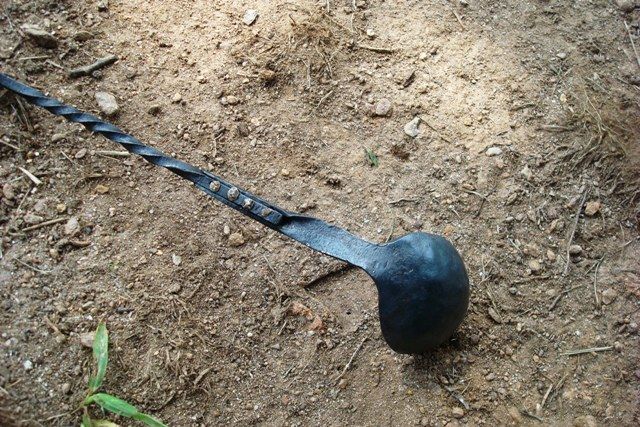

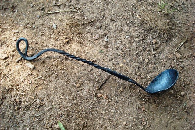

Just finished this up today. Made it for a blacksmithing demo for some kids who were visiting the farm.
Ladle head forged from mild sheet steel, and riveted onto a 1/4" mild steel handle. Heavily wirebrushed then coated with beeswax finish.

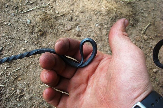

Then my big dirty hand showing how that funky looking handle fits.

Nice. I bought a swage block and it has multiple ladle/spoon depressions. I'm looking forward to making something like that.

No,No,No, you take a 8" bar of 1/2" round mild steel, upest the end to a 1" ball and forge out the spoon, draw down the rest to 1/4" square, taper the tail, and twist. That is how Sam does it.
I'm saving those projects for when I have a power hammer. I don't have the time to do that by hand.
Don't have the time? Or don't have Sam's massive muscly arms to do that by hand? :D :) We all know that Sam likes to do things the hard way ;).
