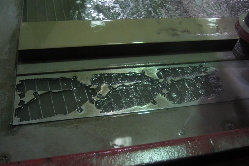

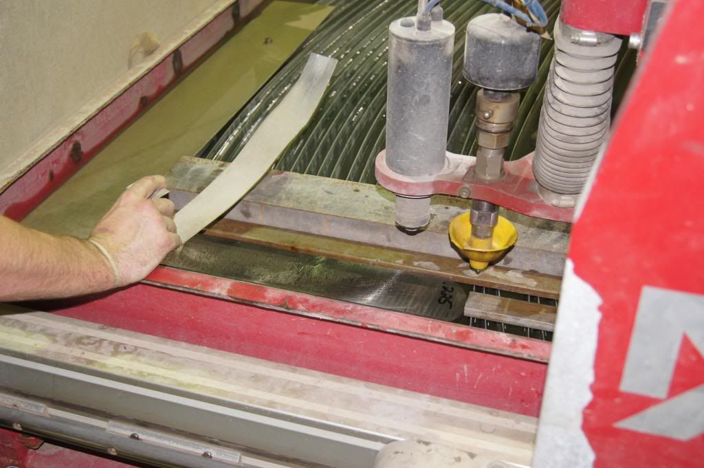

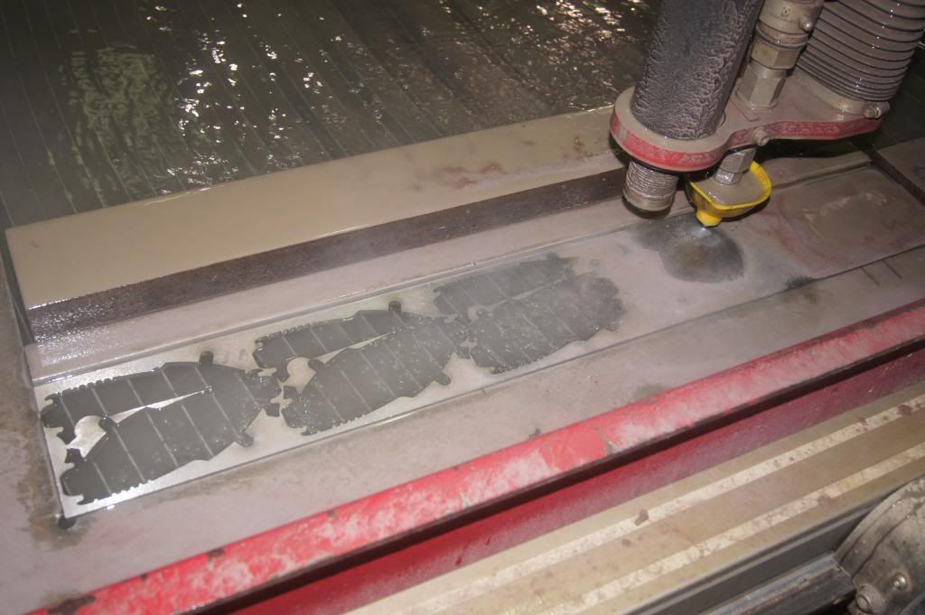

Great! The blades have been cut on the waterjet and the titanium will be cut and delivered next week.

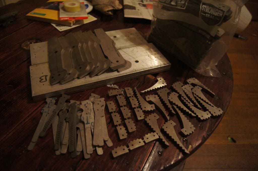

OK so here are the rest of the parts back from water jet. The aluminum fixture plates are done and ready to mount up parts in the mill. So much more to be done but so far everything is going according to plan!
If you have a keen eye you can see that I did a perforation pattern on a few pocket clips. Just experimenting. May add that to all future models once I test the retention.
Very cool! One question -- aside from reducing the weight slightly, what's the purpose of the clip perforation?
