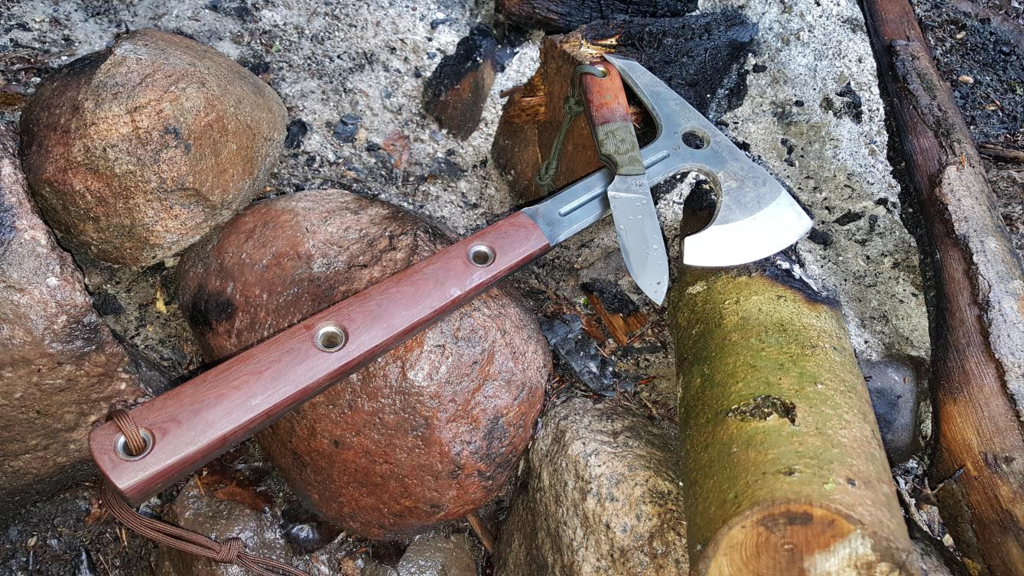

Until then and if...my favorite hawk will be this beard hawk made by my buddy to my specs:
