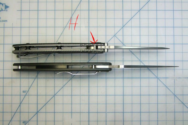

I happened to notice during use that my ZT 0560 made a little bit of a rattling sound upon hitting the spine of the blade on my knuckle. It appears to be coming from somewhere around the tang. Does anyone have an idea as to what this could be?
Also, I noticed during a hard grip of the knife that the titanium frame lock with move ever so slightly to further lock in. Is this normal?
I just want to ensure that this knife is not going to let me down.

I also got the same issue, the sound are cause from loosen blade stop pin.
Moving frame lock while griping hard is normal for any Ti frame lock folder.

You can usually just put some loctite on the stop pin and it will stop rattling. I've done it on all my Emerson knives.
Maybe it's just part of the design.
I know Emersons do it intentionally, so that the stop pin rotates, avoiding wearing a flat spot on it from repeated openings. Not sure about kershaw/ZT though?
Indeed, that is why it's called a "floating" stop pin.
