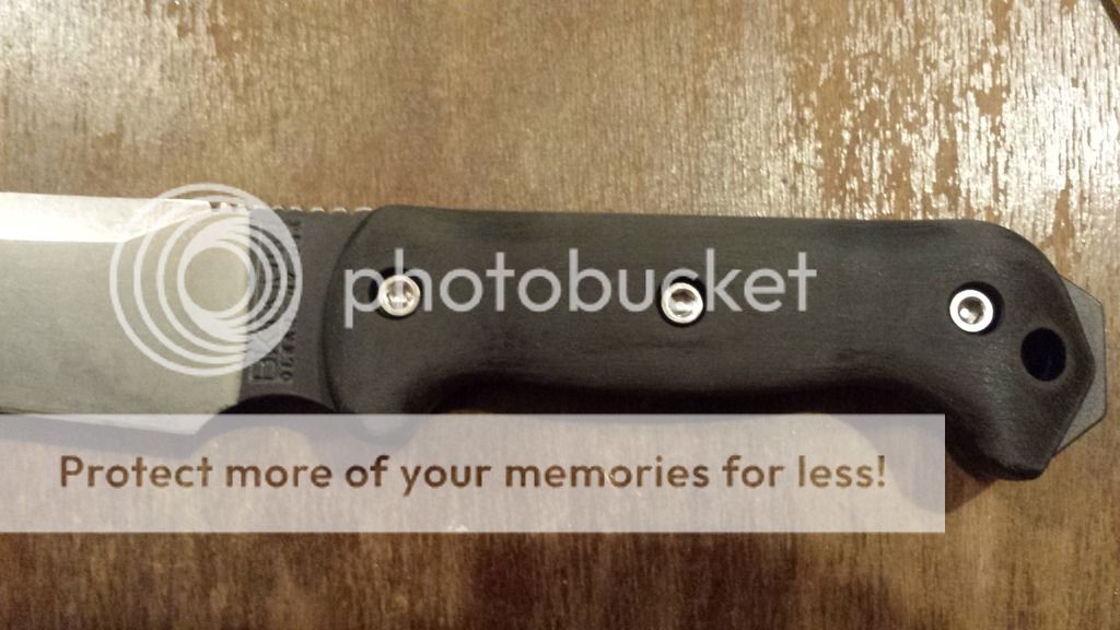

Some of them are a little wonky, I will straighten them out next weekend, but for now she is functional... I also gave my scales a once over with 60 grit. To say that I was Surprised at the amount of grip it added is More than an understatement. I washed my knife down, scales and all, and even while soap covered I felt I had a Fantastic grip, possibly more so than on my micarta scales on my 4...
I think I am going to redo Every Becker I have with 60 grit for the scale treatment.

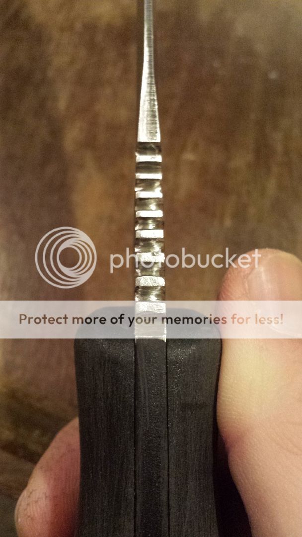

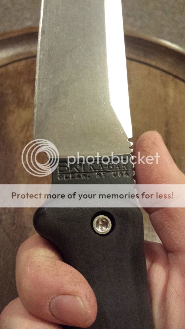

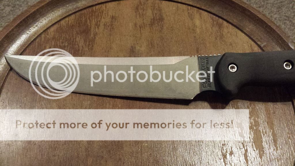

My first attempt at jimping was on my BK5. Turned out 'okay' but I think they're too narrow. Very grippy though and gives me a lot more control when I use the choil. I used a mini-dremel to mark the location of each but used diamond files for the rest of the work.
But I prefer the jimping I added to my de-ramped BK10 later. Used diamond files and chainsaw sharpening files. Damn near perfect, even if I do say so myself. ;)
Used a spindle sander with 320 grit to finish the spines.

After hearing complaints about the gimping on the Griptilian, I thought...it's not that bad but it could be better. I know it's not the knife in discussion but functionally this is the best jimping I've every had.
Both the dremel and knife were hand held, and hazy safety glasses didn't help. It actually looks better IRL.
[/url]20150725_112924[1] by Nine4t4, on Flickr[/IMG]
Had I been patient and done it properly on a bench it would have looked factory made. The points dig into the thumb really well but aren't so sharp that they tear into the flesh. All it took was a dremel cut-off wheel run into the center of the factory jimping. Next time I'll use clamps and a better setup.
