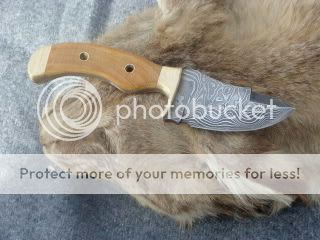

hey guys this is a little skinner i made for a buddy but the wife took it and wont give it back she said that it hers now ,the nerve of wifes theses days"LOL"now i'm making another for my friend .This skinner has a 2.50" cutting blade with a 1.2" top edge the knife is .200 thick and the blade is 1.3" wide the overall is 6.7" long the handle is osage org.with brass bolsters front and back with 1/4" brass pins .Also it is 60 layers of 1095-15n20 made by me .i have been making and selling billets these day and not much time for making knives .but have 5 i'm working on. thanks for looking .still need to shine the bolster a little if i can get it from the wife :LOL
