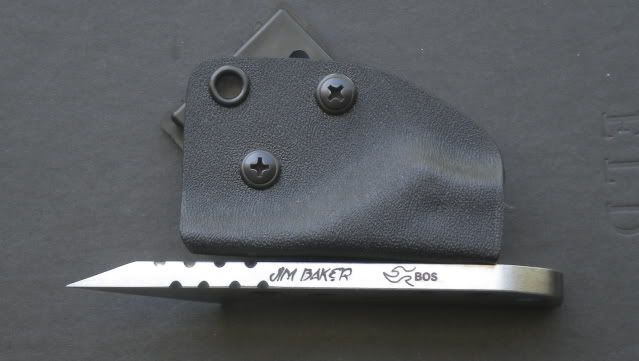

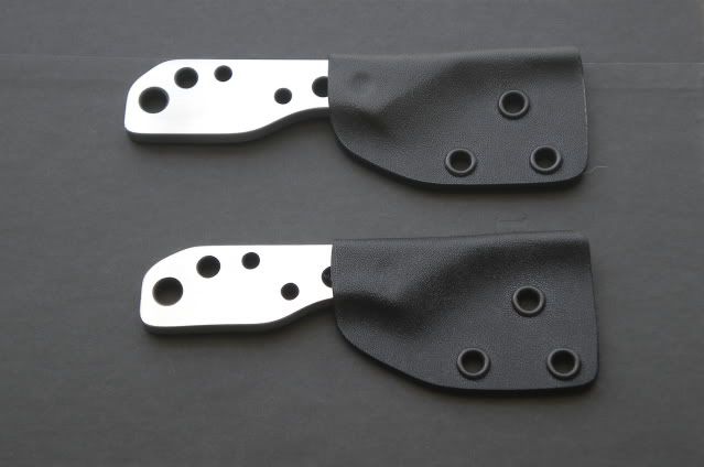

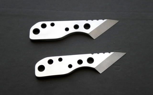

This design was derived from the kiri/ chisel knife I posted a while back. I think I like this a little better personally... something about that needle- like point I guess!
These are A-2 tool steel, right hand chisel ground; 1/4" thick and around 4 1/4" overall length. HT by Paul bos @ 57-59rc. The sheath is set up for a tek-lok and can be worn vertical, horizontal, or canted at an angle as shown (my personal preference).
Thanks for looking!
