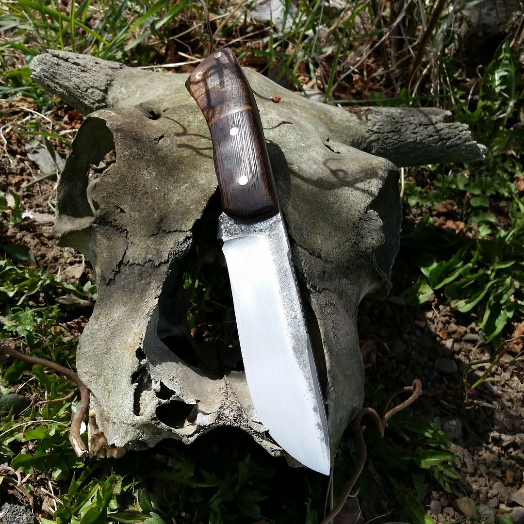

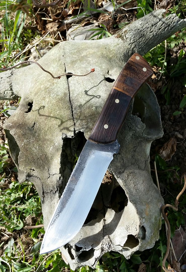

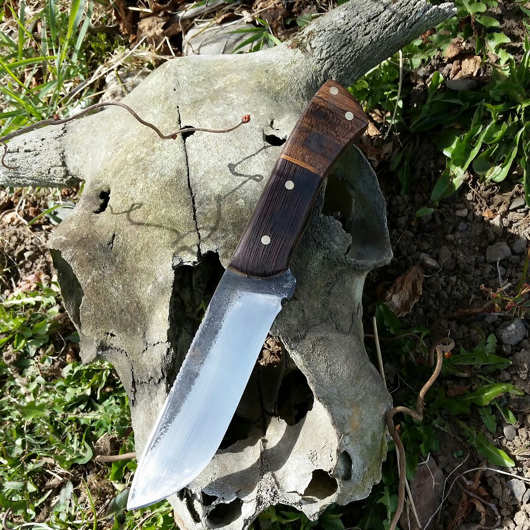

Big bushcraft for a client done. It's a big guy, about 10 inches in total the blade taking up just under 5 1/2" of that.
It made from the recycled 32" diameter saw mill blade (almost out of material!) , of which I always like to keep a lot of the texture from years of use. Gives each knife lots of character! Finished off with a bleach-gun blue etch fir a bit more.
Break down as follows
Length OA: 10"
blade length : 5 1/2"
Width : 1 1/2" at widest
Blade thickness: approx 5/32"

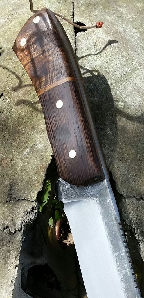

Handle material is wenge, maple inlay, Lou Preto
