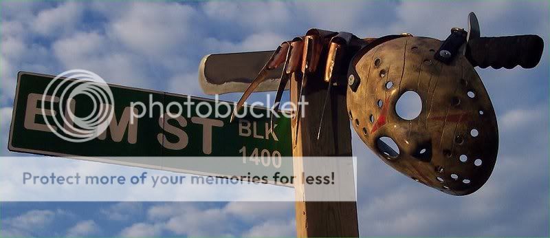

Here's an older one. The handle on that machete is a custom made from that same putty and it's still holding strong.
