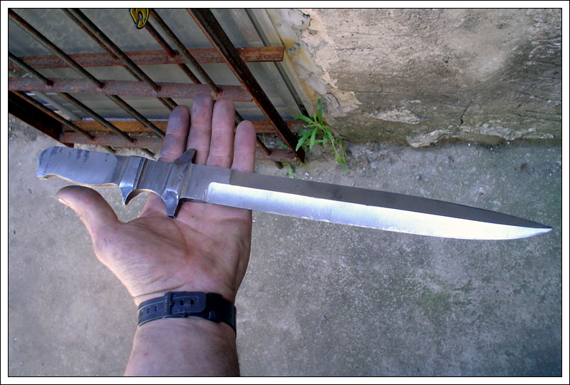

I thought you guys would like to see some pictures of the progress of this :)

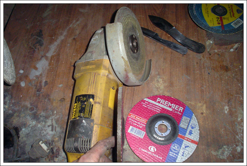

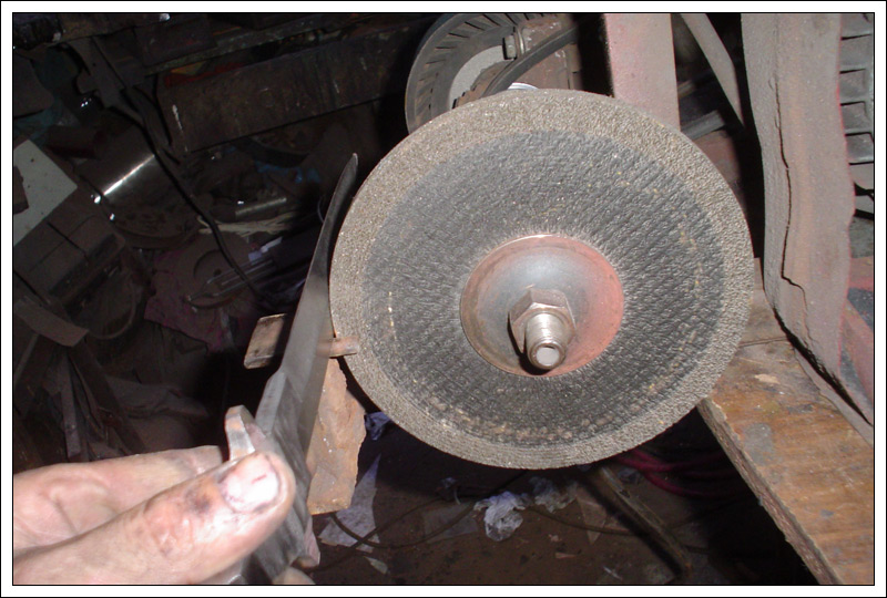

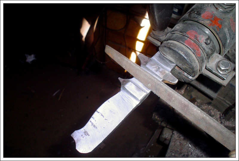

Two 7" diameter x 1/4" thickness grinding discs from an angular/hand grinder.
I place them together on a bench grinder, and with the aid of the supporting piece, I can work safely using leather gloves to keep the blade pressed enough to get a fast rough grinding.

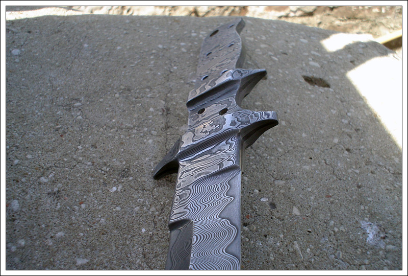

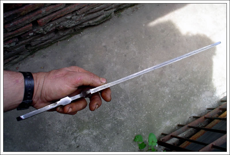

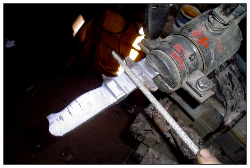

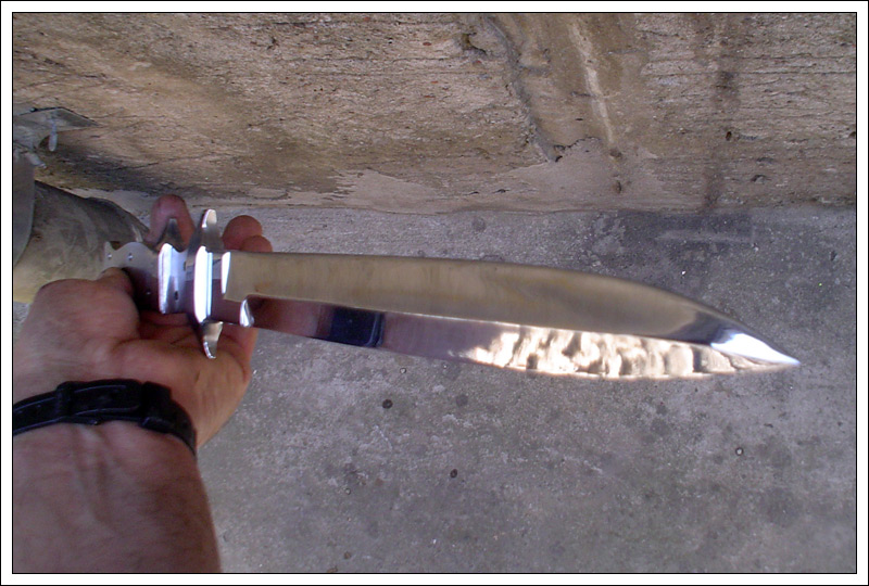

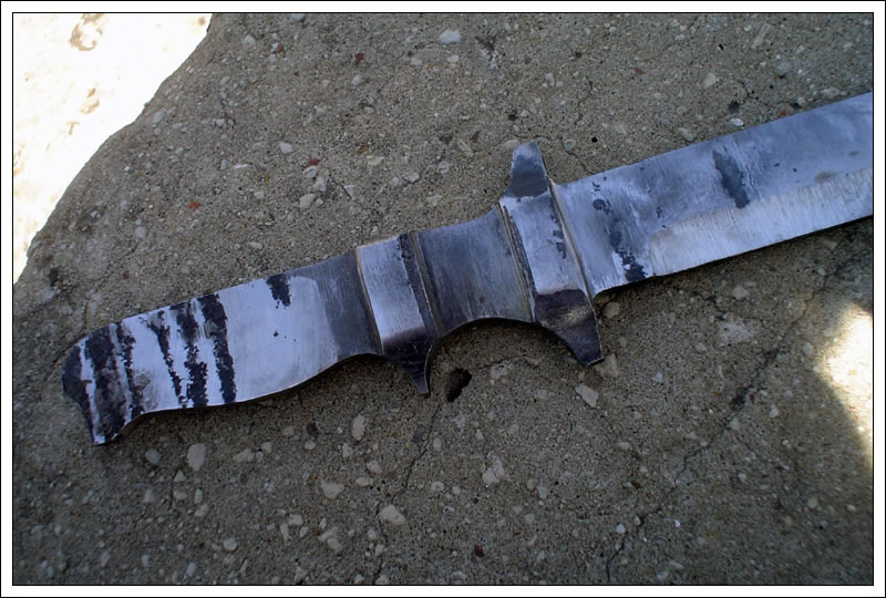

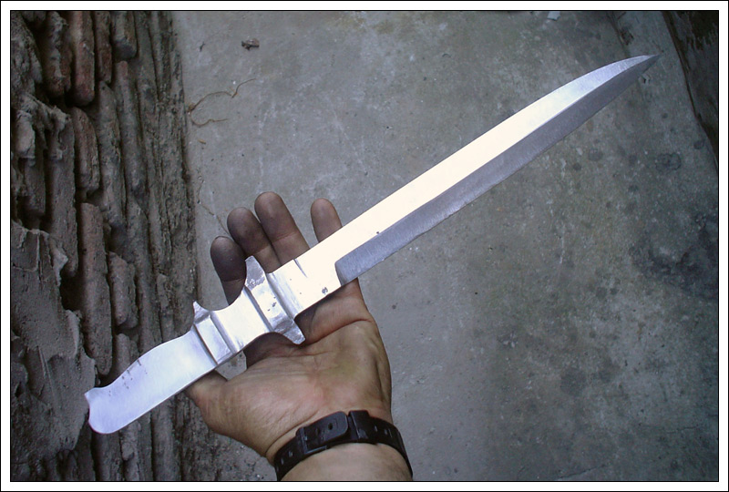

Blade after the rough grinding, showing the swedge. I do the fine grinding after the HT.

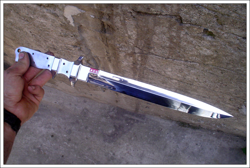

Adjust for the places where the micarta handles will go later (I use both hands, but I was helding the camera for the pics)

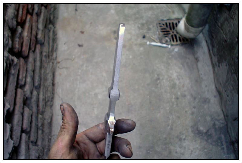

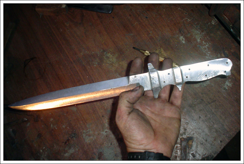

Handle with a medium finish, ready to get drilled.

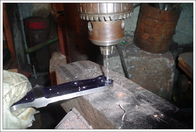

Drilling for the pins.

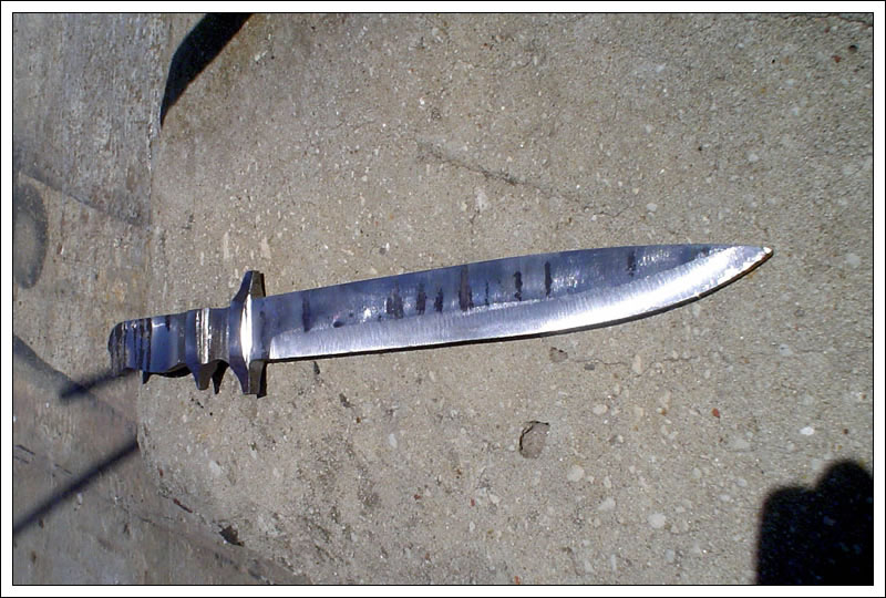

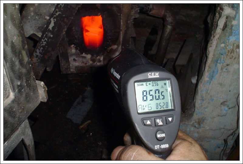

Blade ready for HT.

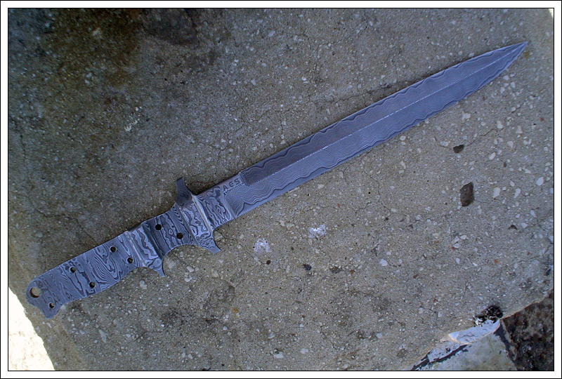

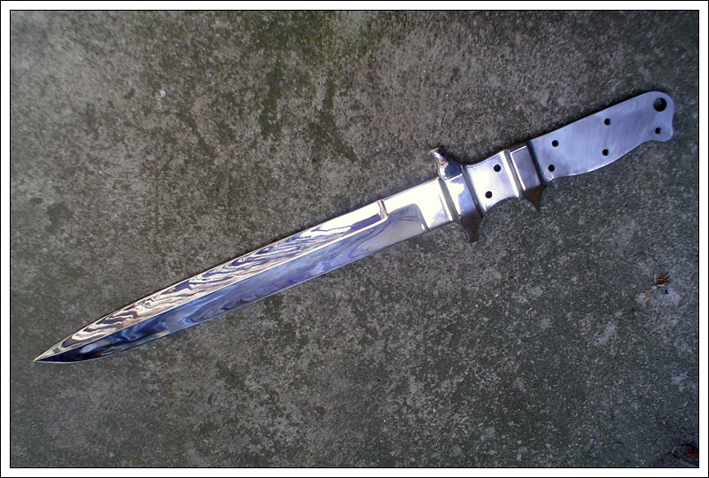

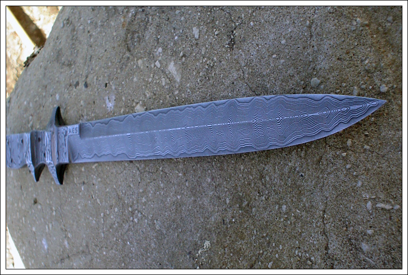

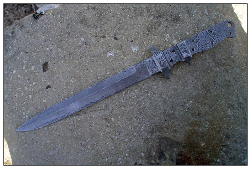

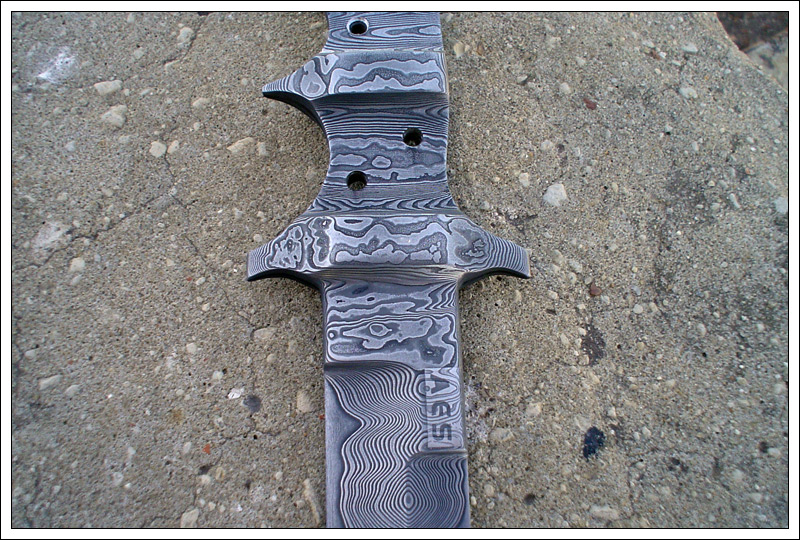

That is looking freaking cool. I am impressed with the level of mirror finish you put on before etch. You could have just about left it like that for a dang good looking knife. It does look better with the etch.
Your level of talent and ability is simultaneously awe-inspiring and depressing. ;)
Outstanding :thumbup:
Going from the pic of the mirror polished blade to the etched piece actually had a emotional effect on me. Just amazing
