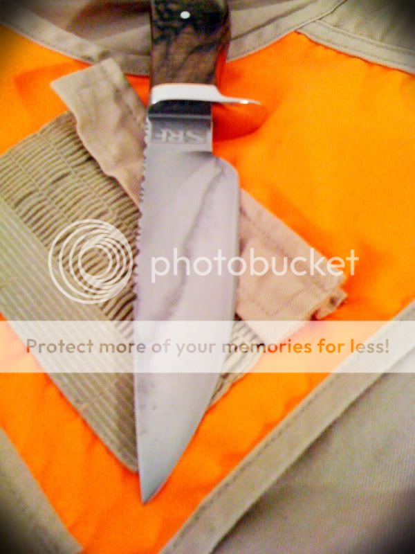

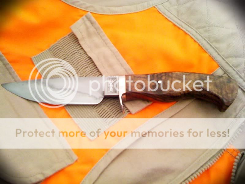

5" from tip to soldered 304 stainless guard. Copper spacer and stainless steel pin. I had no idea when I cut into this chunk of walnut that it would have so much figure and curl, boy was I happy and I think my client will be also. I wanted the handle to be unique so i gave it a sculpted look on the sides which feels quite nice in the hand .Tripple quenched produced a very active temper line. Hand rubbed to 1200, a a a couple dunks in acid then vinegar and polished more times than I can remember. Just a touch of file work on the spine.
Let me know what you think.
Thanks for lookin
