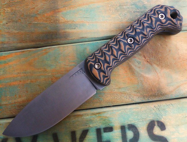

I have a vinegar patina on my bk7- happy to take and post pix if you want to see how the patina looks. It does help w rust resistance!

Seeing pictures might just give me the kick in the pants I need to get it, and they'd be much appreciated.
These were done with boiled white vinegar. Bring it up to the boil, pour it into a pan or tray, leave it for about 15 mins a side and then lightly sand it with some steel wool. Repeat again about 3 to 4 times and you should end up with a very matte grey, almost sandblasted look.
011 by CamH_16, on Flickr
012 by CamH_16, on Flickr
