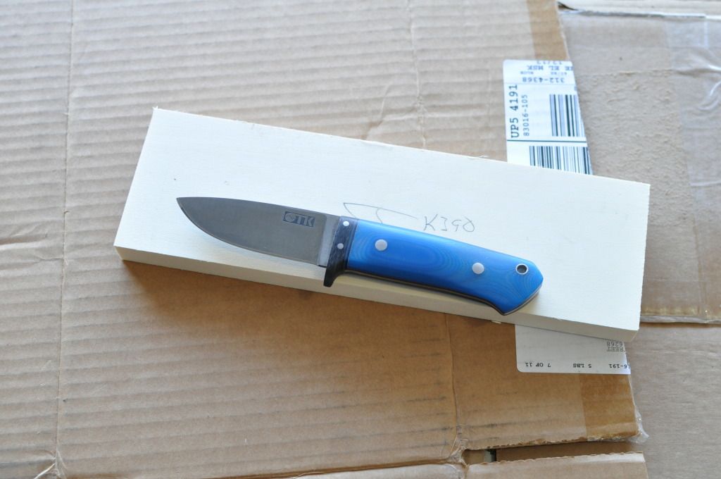

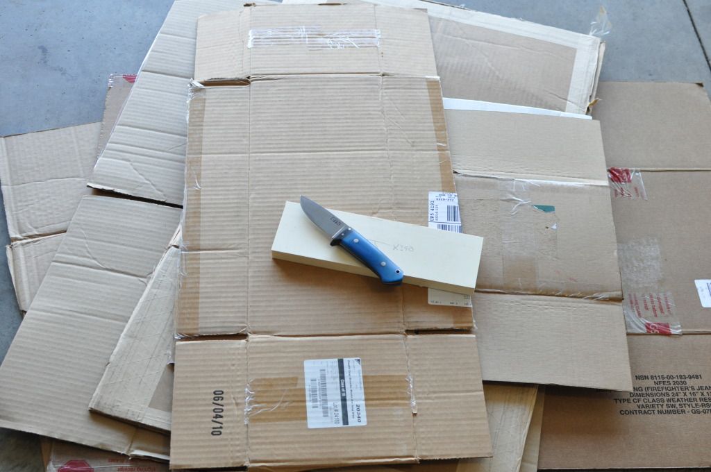

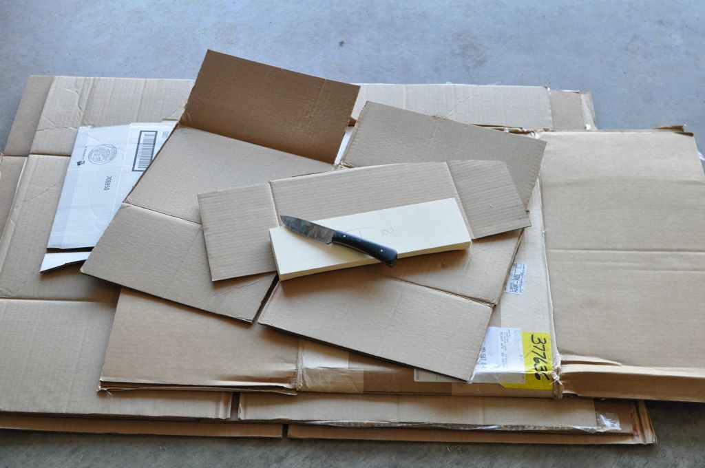

Howdy BF! I figured I would give myself a workout and test 2 of the most wear resistant steels in my arsenal. I gathered up 10 boxes and cut each in half to make sure each knife cut the same boxes. I also added whittling of some aspen I had laying around to test toughness and observe for any edge chipping.
Each knife was sharpened to 9micron using diamond PSA on my EP at 25deg inclusive. Both push cut phone book paper with ease before starting the test.
Just to be clear, this is a steel comparison. I'm not comparing makers :)
Both are nearly identical in respects to alloy makeup and design but there are some subtle differences…
K390 at 63rc FFG (Loveless style blade by David Williamson (OTK)

Some of the cardboard I used. This stuff is TOUGH!

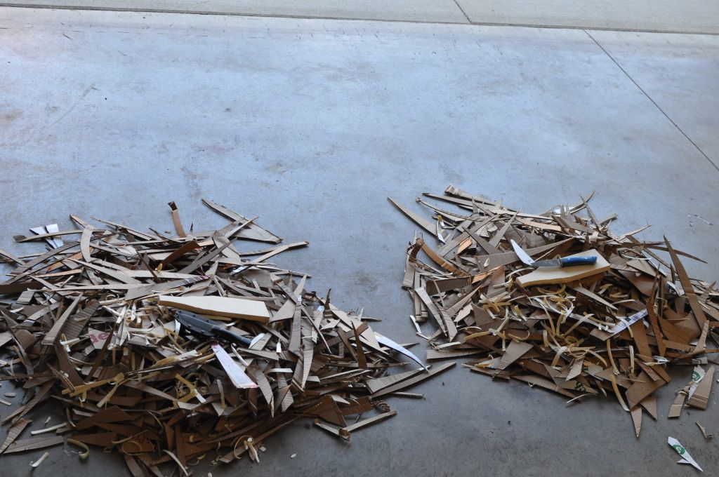

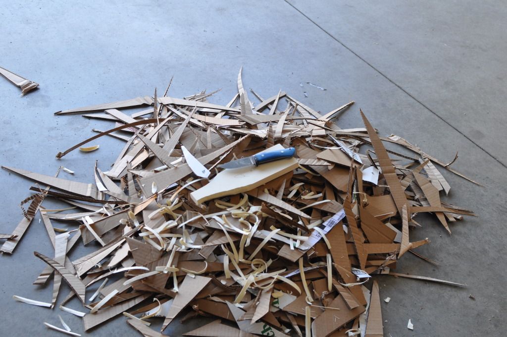

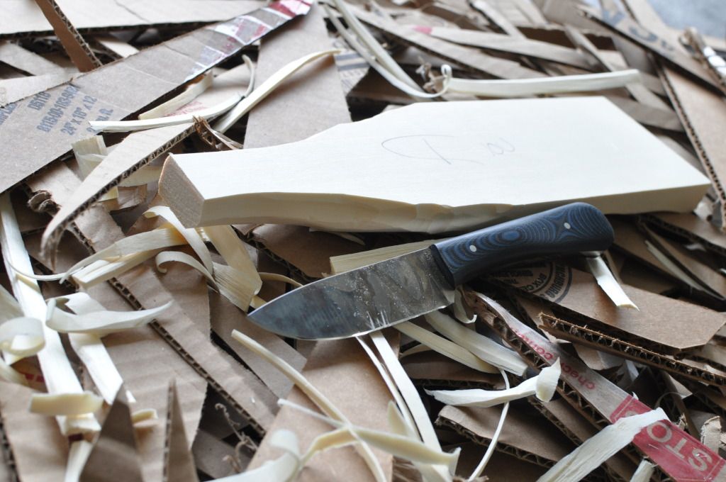

And the aftermath…
Both performed exceptionally well which I expected ;) At the end of the test both would slice notebook (not phone book) paper no problem but when examining the edge you can notice very minor rolling of the edge on the 10V but not on the K390. A few swipes on my strop with boron carbide brought the edge back in line.
