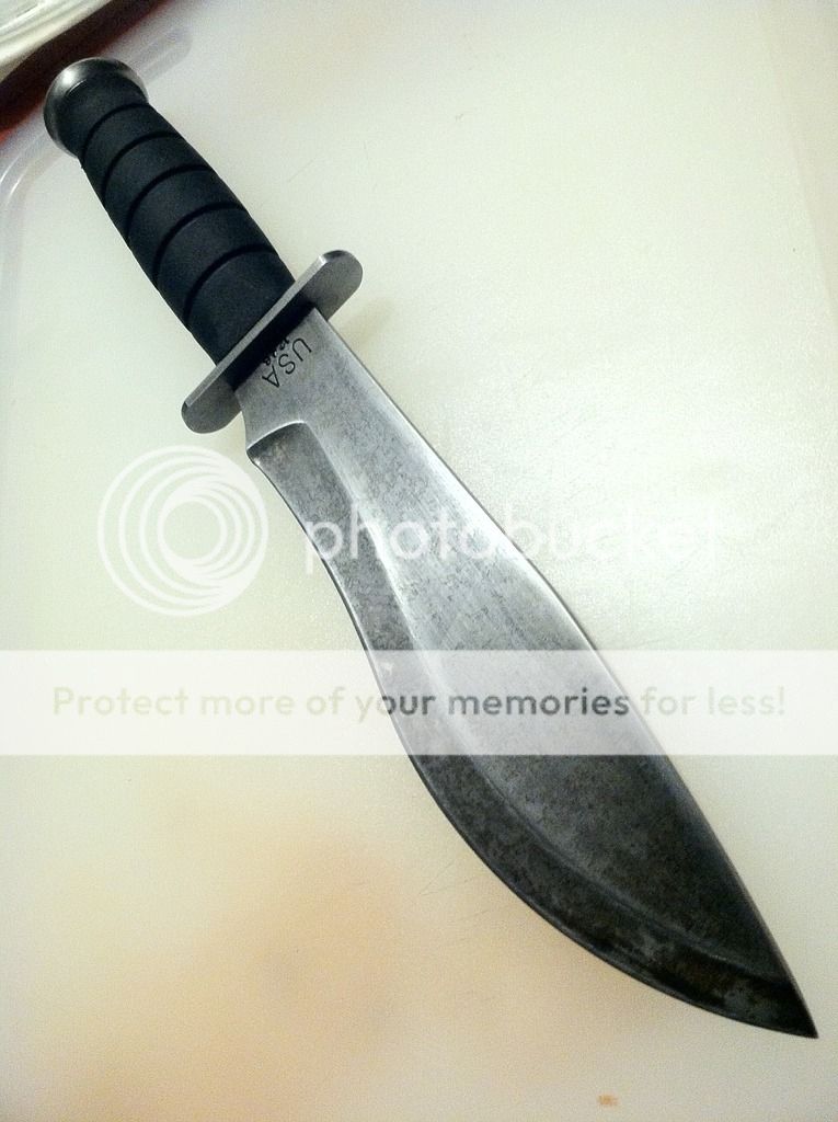

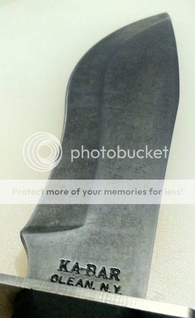

Thanks Logan and Guyon! Just finished the patina...
Just did a quick and dirty patina with a used dryer sheet soaked in vinegar. Wrapped the blade with a soaked sheet then poured some over it to really saturate. Then stuck it between some cardboard with some junk on top to keep it pinched in. About an hour later it was pretty good. Rinsed it with cold water and scrubbed thoroughly with a toothbrush and plenty of baking soda.
Gotta get that guard chopped. Maybe if I stay up too late tonight I'll get sleep drunk and hit it.
