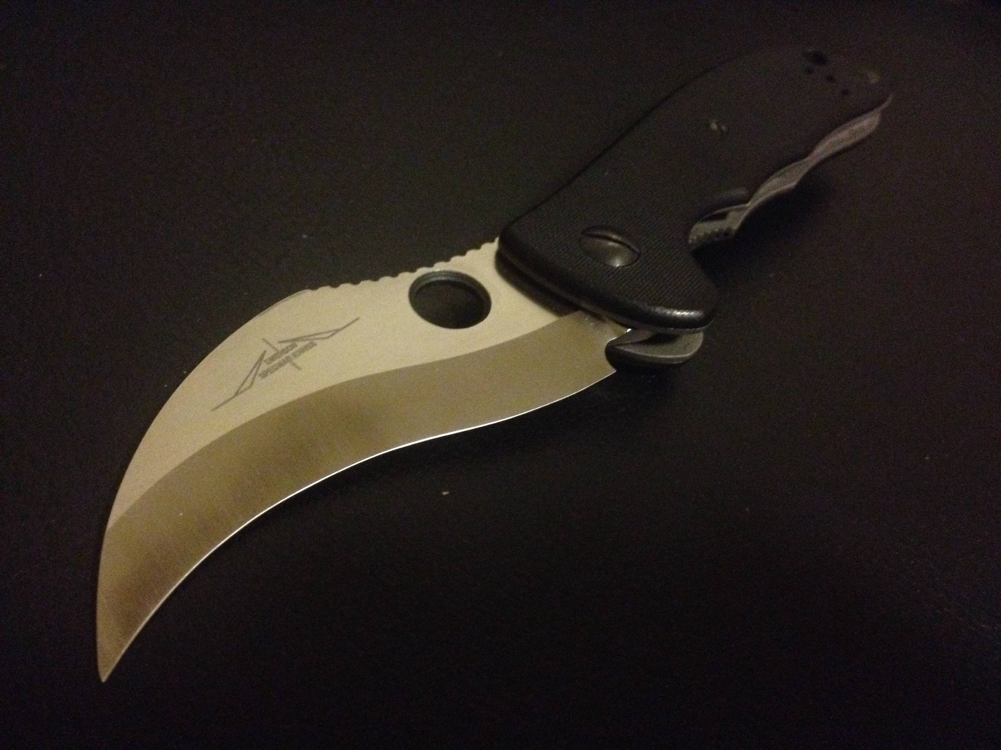

I can't be the only one to think that you can't just talk about a 9 without putting some pics up now can I?
Here's my CQC9, no secondary bevel even though the light reflecting off the blade might make it seem like there is one.
What a beauty....
