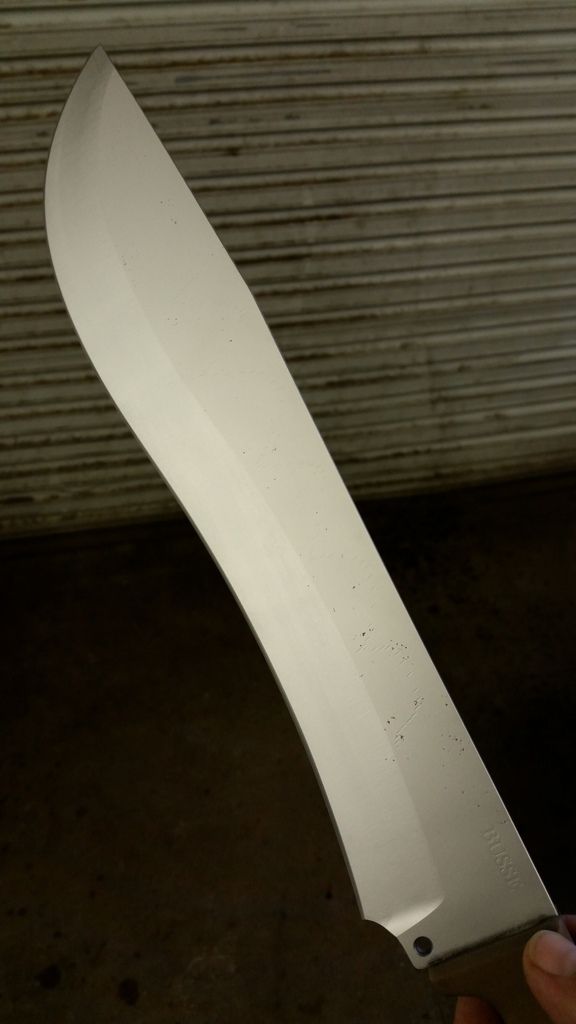

Sent the CG BB13 thru the blasting cabinet today. First res handled knife I've ever done. Turns out that the res is even more resistant to the blasting media than micarta or g10. No visible damage at all. I didnt even chemically strip this one prior to blasting. The dust from black coating on the blade did discolor it a bit but I'm pretty sure I'll be able to get it out.

I usually strip them first so I don't have to blast the area around the handle any more than absolutely necessary, but this one, yeah, 15 minutes or so not counting the logo etch.

Perfect one to start with. The handles are tough and you'll already have the decarb off so you'll basically be giving it a really quick once over to give it that matte finish.
Did yours have any pits? Mine does. I can't wait until the shop runs out of that batch of steel. Lol!

Do you think its possible to sand it to Satin finish after blasting it like that ?
Definitely. The blasting leaves a very smooth finish that can be brought to a shine easily with a little elbow grease. The smoothness of the machine work will be what determines how much work the job will be. I've blasted some that wouldn't require much work at all. This one.......wasn't one of them. Lol!
