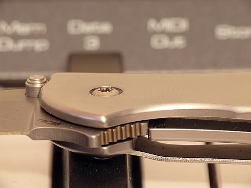

My question is about the frame lock. It's so stiff that I have to hold the handle in my right hand and disengage it with my left thumb...I sliced my thumb nicely the first time I tried it! Is there a break in period for the frame lock? I'm only comparing this to my other frame lock - Leek Dam, which is easy to close one-handed.

It's a bit hard to say for sure from the angle of the picture but the amount of engagement between the face of the lockbar and the tang seems within normal bounds. When you say the lock is stiff is it hard to get it to the point of disengaging from the tang and easy from there on, or is it okay to disengage and just really hard to move the distance needed to clear the tang. If it's the former I'd think you might just have a sticky lock. If it's the latter, well, maybe the amount of spring or the relief cut is off somehow and it should go back to Kershaw for a checkup.

I would say it's the former. After several tries i was able to close it one-handed but really had to muscle it to the point of disengaging. It was easy from there on, so it just needs some breaking in. Thanks!

In that case you could try this - take a regular #2 pencil and color in, so to speak, the part of the tang where the lockbar engages. The graphite may help it stick less. Along with regular cycling to break it in you should be sorted soon enough.
If you have some experience or are confident enough in your mechanical skills to take it apart, i would use some 800 grit on the tang to smooth any friction points. Your lock-up ratio looks spot on. Remember. When disassembling an AO, open the blade first, and use masking tape to cover the edge. Also, make sure you have the proper tools (Torx set).
