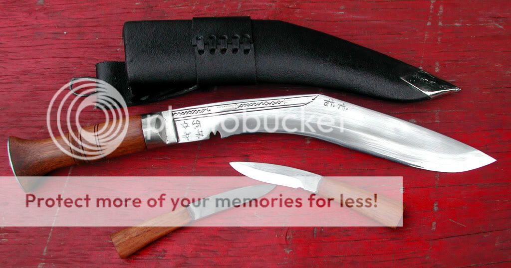

Sarge thinks a 15" Sirupati is an excellent all-round blade. I agree. After receipt, I took it out and smacked he** out of the flat of the blade on a tree. Then I chopped some 2" dried pine branches. Temper is good, and handle is secure. I was going to mirror polish the blade, and do the full woodchuck treatment on the handle, but I realized that this was wrong. This villager was meant to work. Of course, it can be pretty too. The edge got a convex sharpening, the blade got rubbed with some scotchbrite. The handle was quickly sanded with 220 grit only, and 2 coats of Tung Oil were applied over several days. 2 coats of wax finished the wood. The buttplate overlapped a bit, and had blue paint on it. Must have been a car door in a previous life. This was filed and sanded off. The scabbard got a coat of Fiebings Black Leather Balm.
This thing feels so good. I love big blades, but for a little fart like me, a 15" Sirupati becomes an extension of my arm. It's not a great chopper, but will do whatever you ask of it, within limits. Thanks Uncle Bill, Yangdu, and Kumar.
Steve
That looks very similar to a 12" villager I've got that Pendentive worked his magic on. It's one of the nicest little working blades I've ever seen. Good score.

Another fine set of pictures, Steve. I especially like the bottom one. Looks like you did a great job truing up that buttcap.
