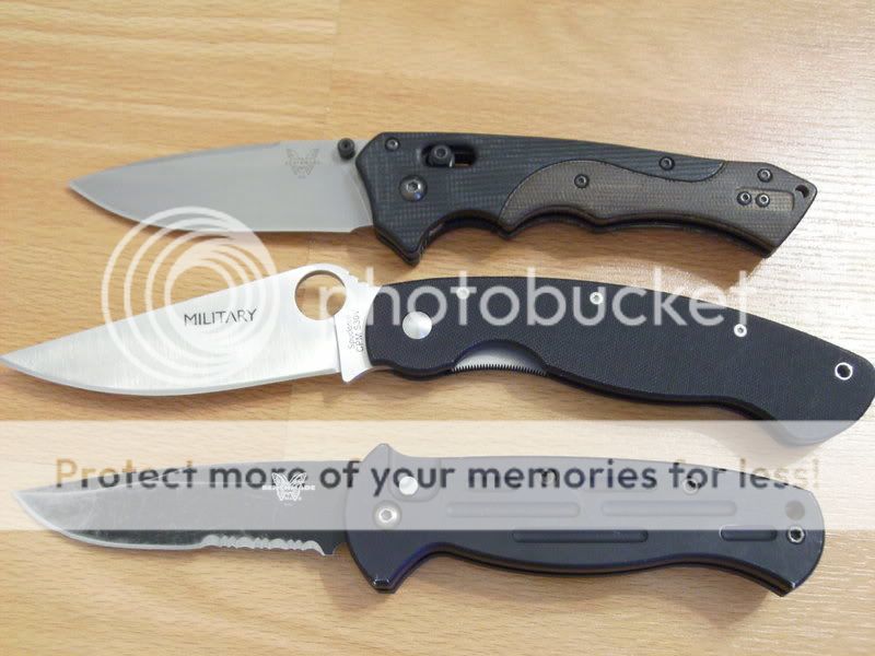

I concur with knifenut1013. If you'll look close you can see a semi-small chip at the front of my Benchmade AFO. That chip use to go all the way through the old edge. It's a lot of work but you can get it out on a decent bench stone or send it to BM for reedgeing. I'll take another shot when I'm complete with it, and I wish I would have taken one when the full chip was there. The grunt that used this knife in the desert did something pretty much the same while cutting.
