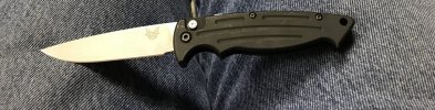

E0ABC880-F7A4-4748-9596-BAF0F0FABBB4.jpeg This Benchmade Mini Reflex is about as perfect as perfect can be. It’s thin, flatground blade cuts and slices like nobody’s business. I got the blade dull this evening doing some work in the bathroom. Stropping would not bring back the edge, but less than two minutes on my DMT diamond rod had it razor sharp again. The ease of sharpening 154cm is a beautiful thing as a certain knife reviewer would say.
