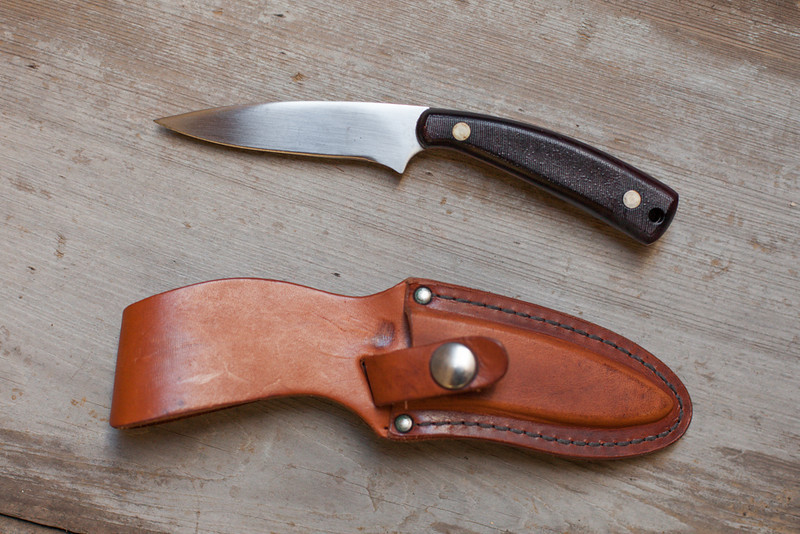

You will note that I have several without sheaths. They are not often seen new without the knife or even in good used condition. Just keep looking is all I can offer. The 152OT sheaths are generally much easier to find.
Nice example of the pattern Trevytrev! The above pattern info regarding the Peterson knives should be corrected to say that the G&A knives were all 152 pattern and the Hunting knives were all 154 pattern, not mix-n-match. Nonetheless, it is still a mystery to me why the guthook version superceeded the plain drop point and remained in production so long. I personally don't find a guthook feature to be that useful. And most experienced hunters I have known have felt the same way.
