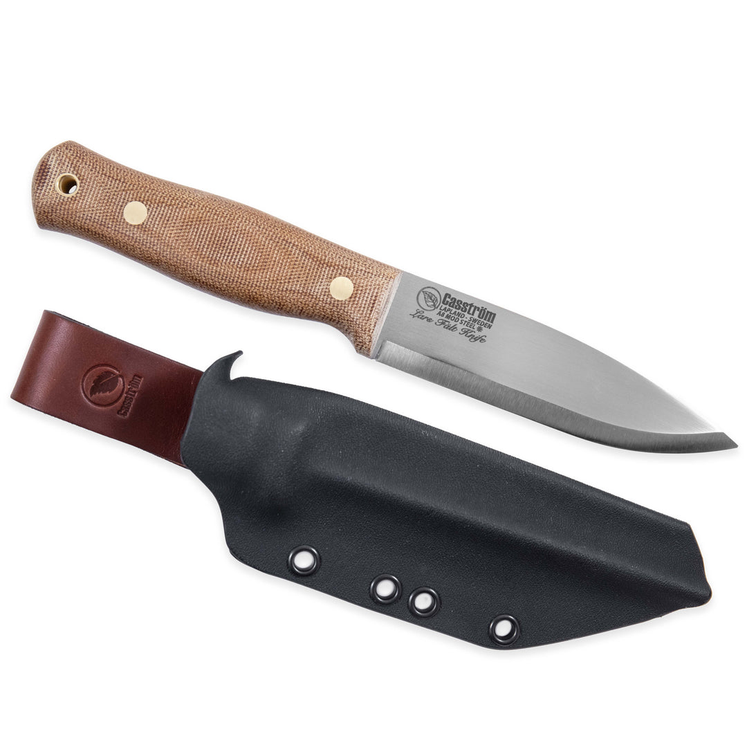

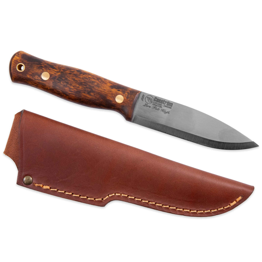

Yes I was indeed looking at Casstrom 😊
I have already 2 pieces of their Lars Fält in A8mod but was now intriged by their new Lars Fält in 15N20 in their Järv series.
They now have sleipner, 14c28n, A8mod and 15N20 In the past they had K720, N690 and 12C27.
Twindog thank you for the numbers.👍
So 15N20 is much cheaper than A8mod.
So I gues they took this steel for the Järv series to compensate for the more expensive leather sheath and handle material to keep the price the same?
Of course I could be wrong and was it choosen because it's thouger so they could make the blade thinner.
edit: just looked at their model 10 SFK and the 15N20 (with leather) is cheaper than the A8mod
I faced the same tough choice a month ago. I decided to go with micarta, A8 Mod steel, and kydex sheath. It turned out to be an incredible knife, superbly made, with absolutely nothing to complain about. The knife doesn't rattle in the sheath, the spine is ground to 90 degrees, and there are no hot spots on the handle. I'm satisfied.

Something to bear in mind is that all three knives in this series have thinner blades and are a bit more nimble than their stable mates. The handles are also a bit more slim due to the thinner blades. I have no experience with A8, but I like 15N20 quite a bit.You do have to like old school steels like O1, 80CrV2, and Carbon V. They are tough, stain easily, are quick to take a fine edge, but won't hold their edge like 3V or Cru-Wear, etc.
