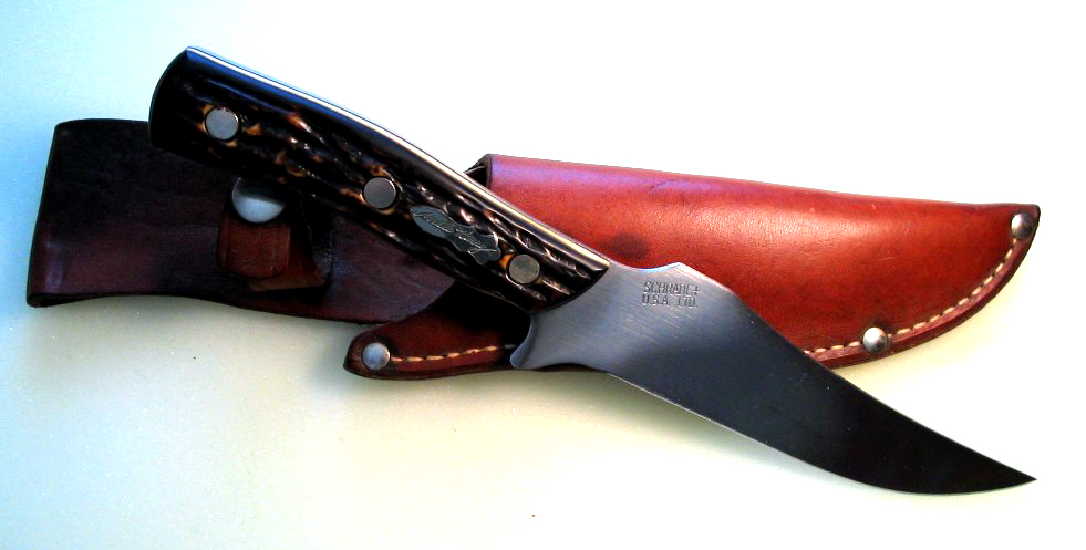

I have one. It is a Ducks Unlimited, with a piercing in the blade of the DU logo duck head. Typical Uncle Henry staglon, DU sheath, box with white slipcase, and I think some papers. Unknown vintage.
I have a DUC15OTF - In 2001-2002 Ducks Unlimited Canada ordered a special 15OT for their Hallmark knife. Using the 15OT pattern blade, they added filed spine, Uncle Henry style Staglon handle covers with a coined antiqued brass DU shield and lanyard hole near the butt, and letters “CI” lasered through the stainless blade. This order was for 55 pieces.
I haven't looked up the U.S. issue with the duck head laser cutout yet. But when I do, I'll be sure to post it. Just an estimation would be that it was made at or near the same time the Canadian version was.
The logos and text of the papers might help us approximate the date.
After Michael pestered me enough :p I dug out the DU15OT info
It had stagalon handles with a hole for a leather lanyard,oval brass shield and stainless blade with the lasered duck head through the blade. Included a genuine leather sheath
The order for 3500 pieces was ordered 07/2001
Delivery was scheduled with 600 pcs on 3/1/2002, 500 6/1/2002, 900 8/1/2002 600 on 9/15/2002 and finally 300 on 10/15/2002

Duh! I should have remembered........one of the second or third Schrade blanks I finished was a 15 with a duck head cut out. Now I will have to check it when I get home & see what the tang stamp reads; likely it is 15UH.
Thanks Larry & Codger for refreshing my memory.
Dale
Dale, IIRC, these later stainless SFO 15OT patterned knives did not use the "UH" identifyer on the tang. I am not able to dig mine out at the moment to check it. It is most likely SCHRADE+ over U.S.A. LTD.
This is what was specified on the sample request form.
I think you are right.
The blank I completed was like the last one you show with the cut-out, but without the etch.
