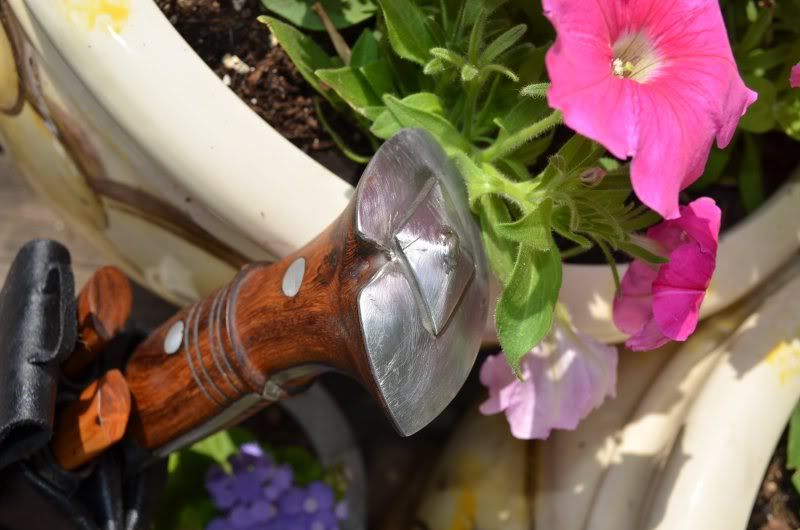

A huge dent in the brass ...
I like to think of them as personality marks:
Too bad about M4cr0s Kukri and Tung Oil project but he'll recover because he is tough. But wow bric how did that happen? Looks like the steel was cut and wood knocked off with it. Very interesting damage. Looks like Mayhem has been busy.

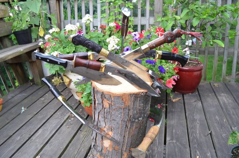

Mayhem is about right...let's just say that I no longer recommend the following as a Khukuri storage option:
