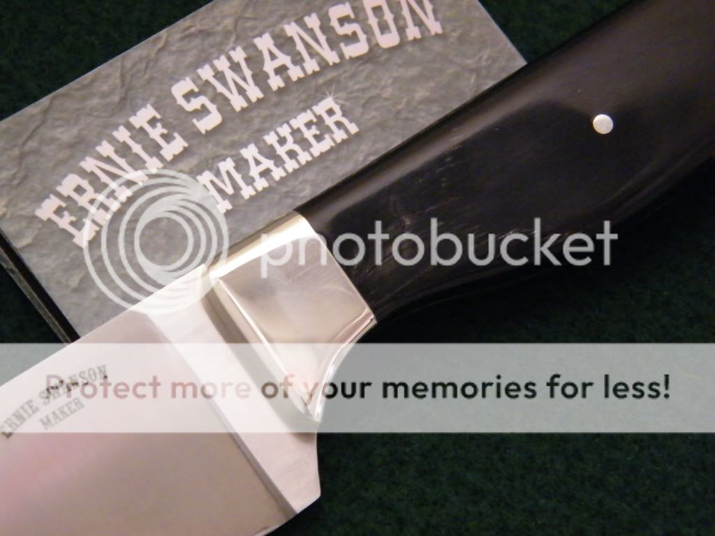

#19, Elmax test knife, couple firsts for me.
Oct 2, 2009
380
This is my 19th Knife, Its built of Elmax That was provided by Tracy at USA Knife Makers supply.
It contains a few firsts for me, Bolsters and a machine finish. This is the first and probably only knife I did not hand sand the blade. I feel like hand sanding puts more of me in each knife.
Thanks for looking and feel free to comment!
OAL - 9 7/8''
Blade - 4 3/8''
Handle - 5 1/16''
Blade is 3/16'' Elmax
Scales - Water Buffalo Horn hand rubbed and polised.
Bolsters and pins are polished nickel silver.

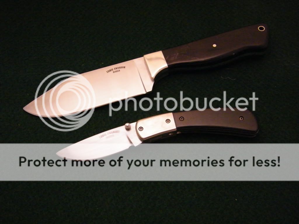

And here is a couple shots of it with its matching little brother which was also a first for me, A Benefit folder Knife #2 Buffalo Horn and nickel silver!!!
Nice.

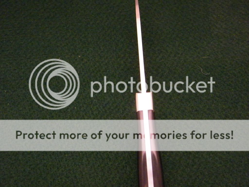

I like #18's design better. Again, work on tapering your tangs.
Folder looks well executed from what the photo shows.
Very clean, Ernie! Well executed. Care to share your opinion on working with the Elmax?
I like it, not bad to cut or grind. I only hand sanded the spine and that was really no different than CPM154.
I cant wait to see how it cuts!!
When I run out of my CPM 154 stock, I think this is going to be the next steel that I play with. Unfortunately I still have enough CPM154 for about 15 knives...
