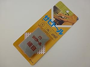

I have this (Sabitoru Fine) rust eraser. Not sure if that's comparable, but it's worked well for me. It's what I used on the Camillus scout knife. A larger block with more surface area probably would be easier to use on the Western, though.

The Super Eraser works really well you can get one for about $10 off the internet just Google it. For polishing I use Flitz metal polish and a micro fiber cloth with a ton of elbow grease.
