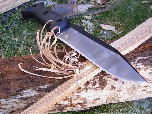

Some of the nicks were so deep that sharpening them out would remove a full 1/8th in of steel and make the edge bevel extremely thich at the shoulder. I don't own safe queens and as much as I wanted this knife to stay as it was given to me I felt that I wouldn't use it due to the thick edge.
I decided that this knife wanted to take a beating and it was wrong to let my nostalgia get in the way. I gave it a full height convex saber grind. I removed the platen from my 2x72 and reshaped the whole thing. This was only possible because the knife's flats were actually mildly convexed with a high point above the grinds mid point. Now I have a knife that I can use as it deserves. It is Razor sharp, with an edge finished to the 9 micron belt and then stropped. Here are some pics of the knife now. I also have pics of wood processing (A LOT) on my camera and will download them shortly.
Bk7 with convex saber grind

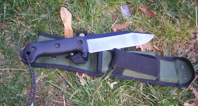

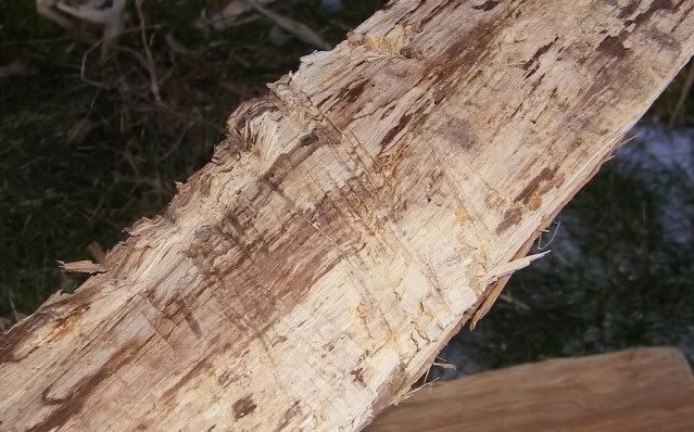

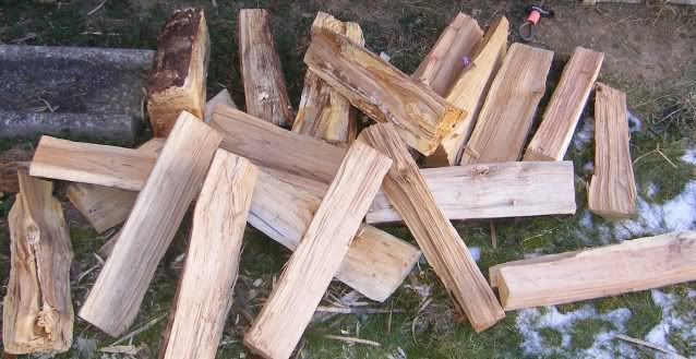

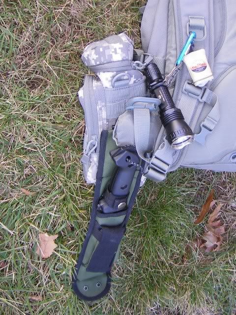

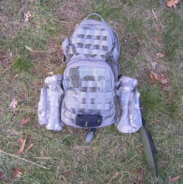

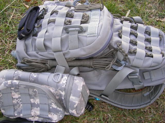

I found a naked spot on my current pack. I wear this at work daily.
Naked no more, new home for my Bk7
Did I mention its sharp
