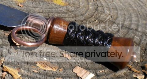

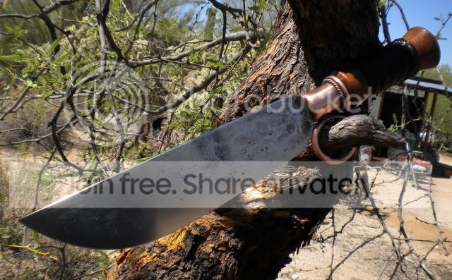

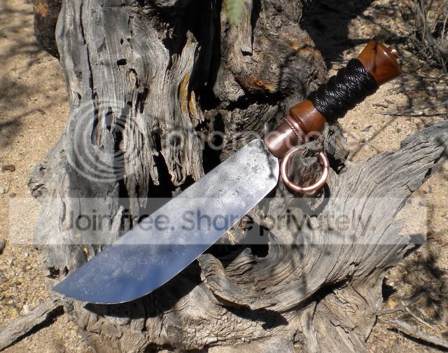

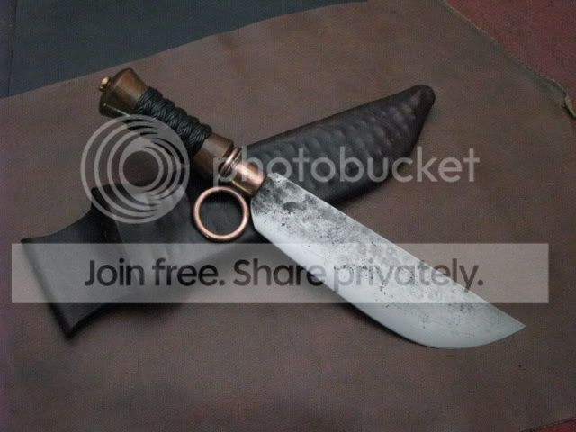

Here’s a neo one, my first “Bush Ringer“. :)
Ray Richard is going to make a sheath for it.
13-1/2 inch OAL
8-1/2 inch blade
1-1/8 inch ring inside diameter
Blade- 1065 steel
Handle- Walnut wood with woven cotton wrappings
Ferrule with ring- Copper
That is Bad A$$! One question, how is the ring attached and how would it hold up to a short blow ( missing your target and hitting the ring with your finger inside )?
Scott
Nice piece, Tai. I like how the blade seems to have poured/grown out of the handle. You mentioned in another thread that sometimes the handle inspires the blade.... this looks like a good example. Now, figure out a folder with that ring... where you can spin it on your finger and the centrifugal force opens the knife.:thumbup:
Rick
Thanks guys!

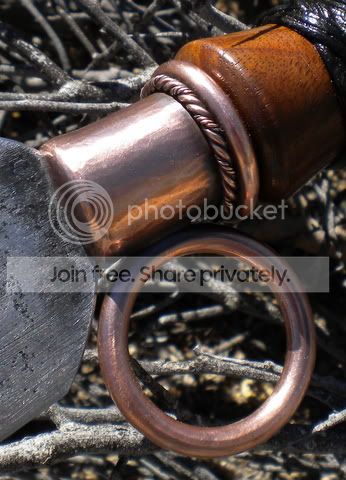

Scott, it’s silver soldered to the ferrule and very solid. I filed a flat spot on the ring where it attaches to the ferrule to give the seam extra surface area. If you missed a target and hit the ring, nothing would happen, accept it would protect your finger. It is copper though so throwing it probably wouldn’t be a good idea. If it was hit hard enough from the side it is conceivable (but not likely) that the ring might get bent slightly to one side or another, but bending it back wouldn’t be that big of deal. I did drop it once while I was working on it and it hit the ring,… nothing happened. You could think of it as a “ring shaped guard” and should treat it as such...
Being my first “big” ringer, of course I had to test it out on some of the hardwoods around the shop. Once I got a feel for it, that ring really added a lot to the ergonomics of it. At first I was just holding it with my index finger through the ring, but then started pulling or squeezing down on it, kind of like a finger on a trigger. It added a lot of power and security to my cutting strokes, a totally different feel. You’ll probably see me doing more of them down the road. Fun knife.

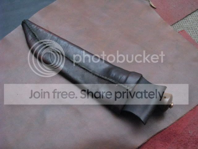

Looks like a throwing knife to me. :D Just got another idea for the sheath after looking at the picture. I just hope this knife can handle this northwest weather. Not bad for an old geeser........

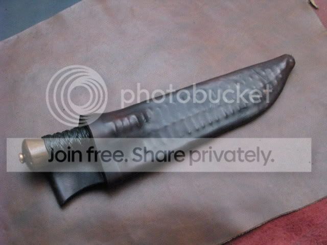

Absolutely beautiful knife Tai, and great job making a sheath that fits the style and type of knife Ray! Curtis is going to love it so much! The love and hard work that went into this collaboration project is just amazing, and if he is a good boy I might actually let him use it once in a while too when I'm not busy with it when it gets here. Thanks so much for creating such a fantastic piece of functional art!

Man, how did I miss this thread? I love looking at the shapes and textures. I really dig that hammered ferrule and wire detail. The sweep of the curve of the edge. The pommel details. So much excellence to look at. You're one hell of an artist Tai.
