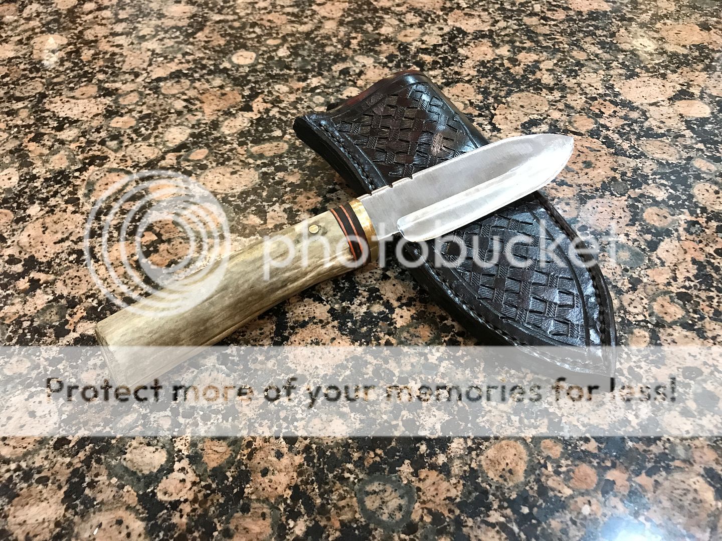

The sheath is really well done. The knife makes an excellent EDC or Sgian Dubh. Excellent first knife and sheath!!!
A few suggestions for the next one would be:
Shorten the ricasso by almost half. The neck between the handle and the edge is too long.
Also, I think five jimp marks would have a better look and finger grip for the thumb.
An additional feature you may want to try is a butt cap matching the bolster.
The only thing that looks off is the edge. It looks like it is not straight. Part of that look may be the overly rounded heel. This isn't a killer issue, just one to consider on the next knife.

But, from what I can make out, the knife and sheath do look good. :thumbsup:
