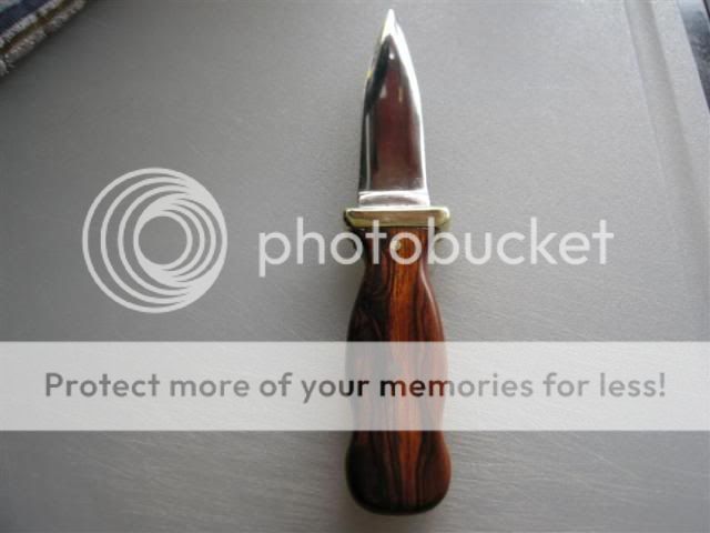

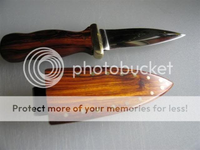

This is the first knife forum I ever visited and don't really know the layout yet. But I recently got interested in making a knife and did so. I've made a couple more since, surely nothing professional but still functional. The first one was made from an old file, some melted down .223 brass and some ironwood. My curiosity got me and I was wondering( if I missed it) there is a thread on pictures of first knives made? That would be real interesting to me.

Here's the first one I made. Ironwood, an old file and some melted down .223 brass. It's pretty basic but a chore with the tools I had and lack of experience.

knife looks good. did you cast the guard? If so can you tell how
Yeah, the little cube in the components picture is the melted down .223 brass. I had to make a metal melting pot and then I used an acetylene torch to melt the brass . I made a mold out of plaster . Then you have to grind it down to shape and make the tang slot. That's the time consumer if you have to do it with garage tools.
