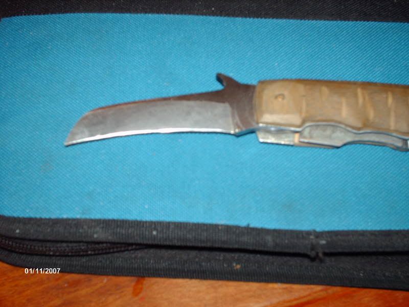

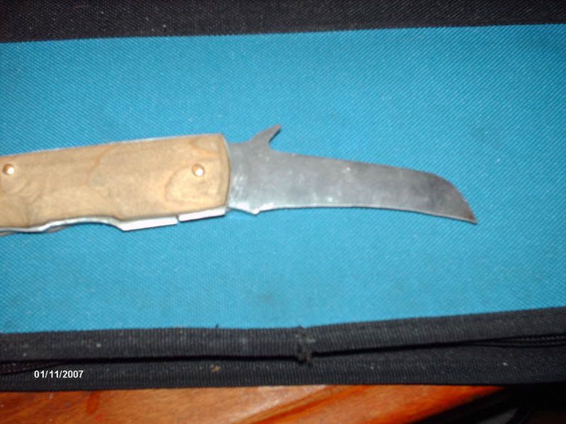

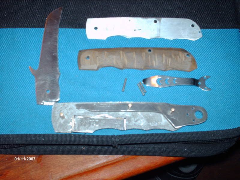

not finished yet but tell me what you guys think!
its ground on 1 side of the blade
has a modified liner lock of my own design
and waved
and the pocket clip placement allows for it to be there and not bunched up in the hand while in use
this will be my edc for work
blade is d2 and im thinking about putting some hickory on it instead of what i have now
Looks like that should clean up nicely. I actually carry an Emerson as my EDC the Wave feature is very nice.
thanks what type of finish should i go with taking in consideration this will be used hard and scratchers are going to be many
I have had and made many differently finished knives. Scratches happen on all of them eventually. Satin finishes seem to hold out the longest.
On some of my very hard use knives I have made I have just done a satin finish then covered the blade in sharpie then made interesting designs in it and acid etched. It does not seem to scratch easily. You have to make sure to clean the blade though.
